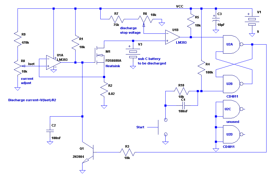

Guys, I'm planning to build a battery discharger for a single sub C type battery. I need an adjustable cut-off circuit that ranges from .9V down to .6Vdc. Any help would be gladly appreciated. :)
Here's a circuit that should work. I have simulated it, but it has not been built. You can substitute any MOSFET with an Rds(on) of 30 milliohms or less. You'll need a heatsink for the MOSFET, as it dissipates several watts during discharge.

I looked at a product description for the **broken link removed**. It seems to me that you can build 6 of these circuits, all powered by the same 9 volt battery, controlled by the same pots for current level and discharge voltage, and started by the same switch. The batteries cannot be connected in series or in parallel. They must be discharged individually. If you use 6 of these circuits, they will all stop discharging at exactly the same voltage, independent of time, which I gather is what you want.

Discharge design
RON, in your design, can U1A be used like an opamp as part of the battery current sink? I've never actually used a 393 like this before.. but I've heard rumors... :) Saves a part if it can..
I can't remember if I have actually done this in hardware, but I've simulated it in several circuits. In this circuit, R1 and C2 form the dominant pole in the feedback loop, compensating it against oscillation. So long as the loop gain goes below 1 (0 dB) while the phase shift is less than 360 degrees (including the inversion), the loop will be stable. This means that the loop gain has to be below 1 before the other poles (RC time constants) inside the comparator become significant. Since we don't need high closed loop bandwidth or high slew rate, I figured the LM393 (with the MOSFET) would make a passable op amp if I added C2 to stabilize it.
To clarify:
Each RC lowpass node in the loop will contribute 90 degrees of phase shift in the limit. Looking at the schematic of the LM393, it has 3 gain stages including the output transistor. Each of these will contribute a pole at some frequency. We have to roll off the output stage at a low enough frequency so that the loop gain is less than one before the cumulative phase shift of the 3 gain stages is 360 degrees.

Would it be better to have Q1 pull down the Iset node to shut off the discharge rather than the gate so that U1A doesnt have to drive C2 directly when it is slamming on/off (Q1 will turn on & off very fast)?
If C2 must be driven by U1A, a 50 Ohm isolation resistor on output of U1A is probably a good thing. What do you think?
Do we really care about microseconds when deciding when to terminate the discharge of a battery? In any case, Q1 can dump C2 faster than the LM393 can, because the LM393 output sink current is 18ma typical, 6ma min. Q1 will probably typically sink about 100ma while dumping C2, plus you don't have the propagation delay of the LM393. Also, pulling down Iset would leave the feedback loop active, so any Vce(sat) of Q1 or offset voltage of U1A will allow the battery to continue to discharge, if only at a miniscule rate.
If C2 must be driven by U1A, a 50 ohm isolation resistor on output of U1A is probably a good thing. What do you think?
I don't see any point in this. Why would you need it?
