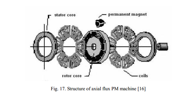

I am making a little dc generator. The generator is arranged in an axial flux configuration, similar to the ones you find in homemade windmills. Similar to this photo, **broken link removed**. I am going to have the coils wrap around iron cores. I was wondering, for the permanent magnets on the rotor, should they only be as large as the iron cores? I am assuming that the coils will only produce voltage from flux traveling through the center of the coils (the core). If the magnet was larger than just the core some of that flux would be traveling through the copper instead of through the center. Would this just be an inefficiency?
In terms of making best use of the magnet's field I would assume matching the size of the magnet to that of the core face which the magnet passes would be most efficient.
I suspect the optimal design is complex. At least, there are lots of papers on the subject. However, to the point of whether the magnets should be the same size as the core projections, I don't see the advantage. The coils will still be passing through the field. Here is an example (source: **broken link removed** ).

I only see two designs. In this axial design, which seems to be what you are trying to make, the magnet faces are larger than the core faces around which the coils are wound. I thought that answered your question.

The design involves many parameters as you know, however I suspect that what you say may cause inefficiencies as the flux from the magnets through the copper may cause a shading effect reducing the o/p and possibly braking the rotor for no extra o/p.
