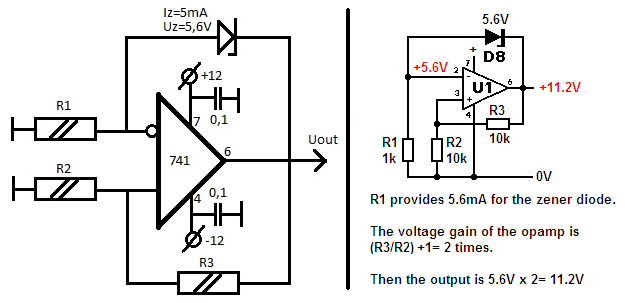

Hello, i have a question how to calculate U out = f(R1, R2, R3, Uz), I tried to calculate, but could not arrive at the result, could someone help me plzz?
Your circuit is almost the same as a voltage reference of a power supply project. The opamp is an ordinary non-inverting amplifier.
