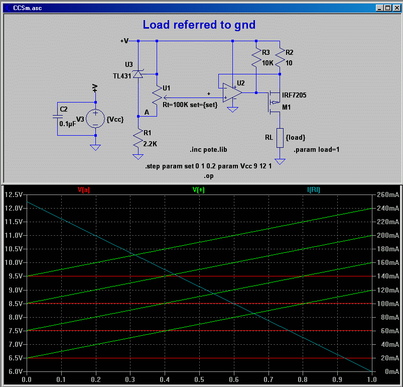

After reading about constant current sources, I defined the four cases shown in the pdf. Current should go up to 250 mA.
Implementing B and C with the attached circuit (and its counterpart) is straightforward, but I am not sure how to proceed for A and D. I cannot have Rsense referred to ground anymore.
How could I go away with no fancy ICs?
Gracias for any help.

How stable is the Supply voltage? If not very stable, then you should use a voltage reference (like a TL431) connected between the supply and the non-inverting input of the opamp. You can get by running the opamp on the same supply (no neg supply needed). I would use a straight PNP Darlington emitter follower or a PFET; not the compound NPN-PNP inverting connection which is likely to cause instability because it is inside the opamp's feedback loop.
Here is how I would do a ground-reference Load: Simulation is for load resistances varying from 1 to 15 Ohms at four different supply voltages: 9,10,11 and 12V

With the TL431 you ensure a stable value at the noninverting input but V+ could still change wildly, right?
I would like to change current from 0 to 250 mA at will.

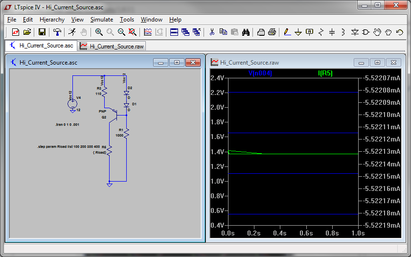

Last night I started to consider using a current mirror. Is that too daring?

A current mirror built out of discrete NPNs, PNPs, and diodes will have a temperature drift problem. Using a TL431 in place of the Zener would greatly improve the Power Supply Rejection Ratio (PSRR), and also improve the temperature related drift. Here is a way of making it adjustable:

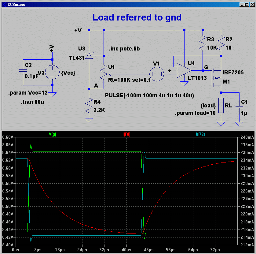

Can you throw some capacitance on the output and see what happens? e.g. 1 uF

Here is the transient response. V1 introduces a 200mV step. The settling time and over-shoot of V(g) is the critical node to watch.

I simulated the bipolar current mirror in LTSpice and Proteus ISIS using 2n3906 as a current source. . LTspice sims it fine...it does indeed work. ISIS has issues...things like Vce-SAT in excess of spec going on, end result being currents aren't mirrored at all.
EDIT: Multisim Blue seemed to do a better job than both other sims w.r.t. Vce -sat . I t showed an 8% variation in current when using different colour LEDs and Vf as the loads.

Interestingly, I was trying to establish a constant current for some 7 LEDS (3.2Vf) from a Li Ion battery...3.6 to 4.1V with emitter degradation and a base V ref with NPN's works but requires as many resistors as transistors (7) plus a Vref. About 16 parts for constant current.
Resistors (22 ohm) alone cause current to vary from about 40mA down to 18mA over the batteries useful voltage range. 7 parts, current with 55% tolerance
Using the current mirror bipolar approach (8 transistors) a single 82 ohm derives the mirror currents at 40mA/4.1V which drops to 34mA at 3.6V from the LTspice sim. 9 parts delivering a current with 15% tolerance.
Seems the current mirror will do the trick in a tight PCB that uses discrete thru hole parts.
