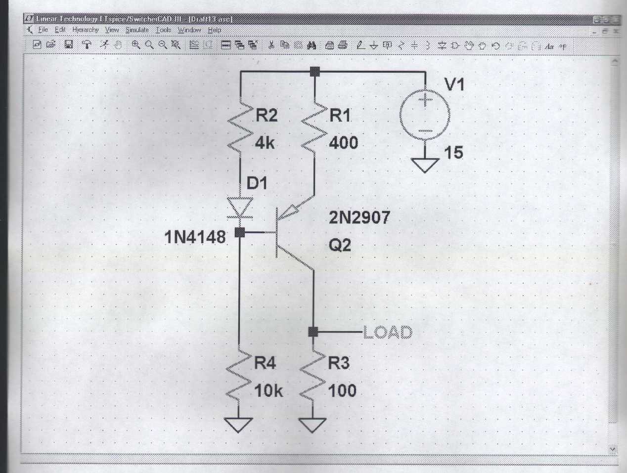

well, you asked for the specifications ,
i need a max 10 volts voltage and a constant 10 mA current in a PT100 tempreature sensor that vary starting from 100 ohms at room tempreature.
Honestly, i dont know many details, but .. any one who needs info to help me .. plz ask me !
thx for the advice and for the efforts
solom hamada
A PT100 temperature sensor has a resistance of 100 ohm at 0 degC, and 138 ohm at 100 degC.
Putting a current of 10mA through 100ohm will dissipate 1watt, resulting in the sensor heating up and not reading the correct temperature.
I think you need to re-evaluate your current requirements.
The temp sensor will send out smoke signals with such a high current.
Didn't you look on its datasheet?
Edit: Wait a minute! 10mA through 100 ohms is only 10mW, not 1W.

This is a constant current 10 mA source. R3 is the load. If the load has a positive temperature coefficient, the power in the load will cause the resistance to increase which causes the power to increase- etc. - etc.
Huge sketch with weird values for resistors (400, 4k).
Do you think that only 10mW will cause its resistance to runaway?
I couldn't find its datasheet, but if it is anything like a 2N3904 transistor with a thermal resistance from junction to ambient of 200 degrees C/W, then with 10mW it will increase its resistance with a 2 degrees C error.
