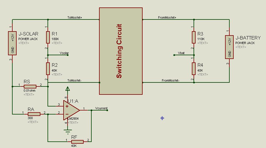

Here's my basic circuit I think I would start with. Please suggest, I am poor in circuit design. sensors.JPG
As Mr. Al has mentioned the input offset voltage becomes important at these voltage and amplification levels.
At 10 amps, the 0.01 ohm resistor develops 100 mV. The LM2904 has an offset of 7 mV, so right there you have degraded the accuracy 7%.
Although you could perform a self-calibration routine in software to take into account that, offset is temperature dependent and thus you would have to recalibrate often.
A better solution is to go to a more modern amplifier like the TLC2272, with only 0.95 mV offset. Less than 1% error is perfectly acceptable for most applications.
Of course, if you even less error, use a chopper stabilized opamp like Mr Al suggests. You can easily find devices with offsets well below 0.1 mV.

where are you going to connect the opamp's ground, to the battery's negative or the load's negative?
It makes a subtle but significant difference. Think about it.

I happened to spot another small problem with the circuit posted. The gain works out to around 134 which means that with 10 amps the sense resistor drops 0.100 volts and the gain takes that up to 13.4v which looks too high depending on the voltage supply source for the op amp. A better choice for the gain would be 100 which would limit the output of the op amp to 10 volts. That works as long as you always have at least 11.5 volts available in the system for the op amp supply voltage.
And as for the input offset, even if there is only 5mv that amplifies to 0.5 volts which represents an error of 500ma in the measurement with a full scale of 10 amps.
So the minimum changes should be:
1. Go with a better op amp unless around 5 percent error is acceptable.
2. Lower the gain to 100 if the max supply is 11.5, but lower if the max supply is less.
As schmitt trigger said, we can not tell where the ground is for the circuit. I assume it is at the input solar panel negative terminal. So the op amp ground connects there too.
You should also look into Hall Effect current Measuring devices by Allegro. Probably a much better choice overall.
I second that vote, unless we need really really good accuracy, which we usually dont.
