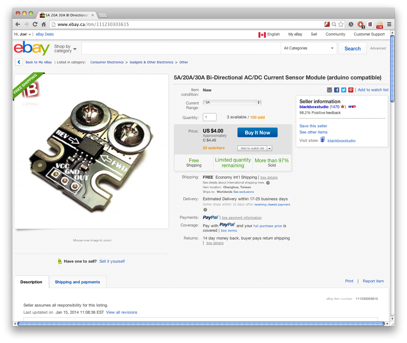

Hi everyone. I bought an inexpensive 20A hall effect sensor board on eBay, and then decided to build a simple meter out of it. I breadboarded the circuit, and it appears to work. What do you experienced guys think about it? Is the design "sound"?
The voltage regulator runs a bit hot (12V input), but I measured 60mA on the output which is within spec. It has automatic thermal shutdown anyway.
I chose such low resistor values to overcome the current flowing through the voltmeter (which only has 20kohm). I considered using an opamp to buffer that end. It would be more elegant, but it added more components and complexity, and 50mA seemed okay to me so I decided bugger it. The 1/4W resistors are only dissipating 1/10W. I could still raise the value of those resistors a bit without sacrificing too much accuracy. (I only wanted 5%) Thoughts?
If I wanted to read the AC signal with a scope, I could simply probe the V(o) since it has much higher impedance right?
Thanks for reading.

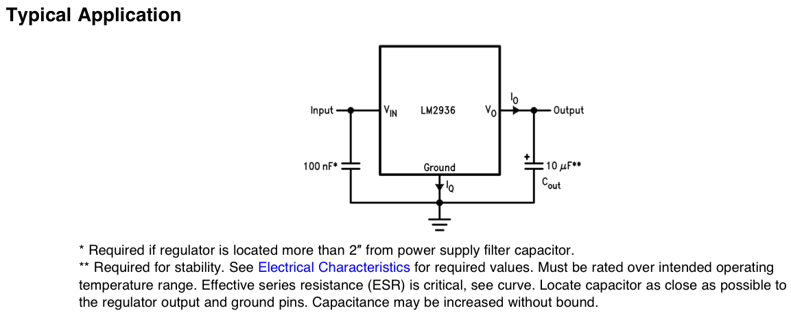

Also, flip your caps on the regulator. Put the 10 uf at the input. Don't use V- unless it's a negative voltage. Use COM or an inverted triangle with a number in it.
Can you explain why? I copied the application circuit from the data sheet exactly.
The voltage @ V- could be positive or negative. I used '-' to indicate that it must be a lower potential than V+.
Well, looks like your right. I seem to remember the other way around. Thanks. I guess this applies to the capacitors that are near the regulator and not the bulk DC caps.
