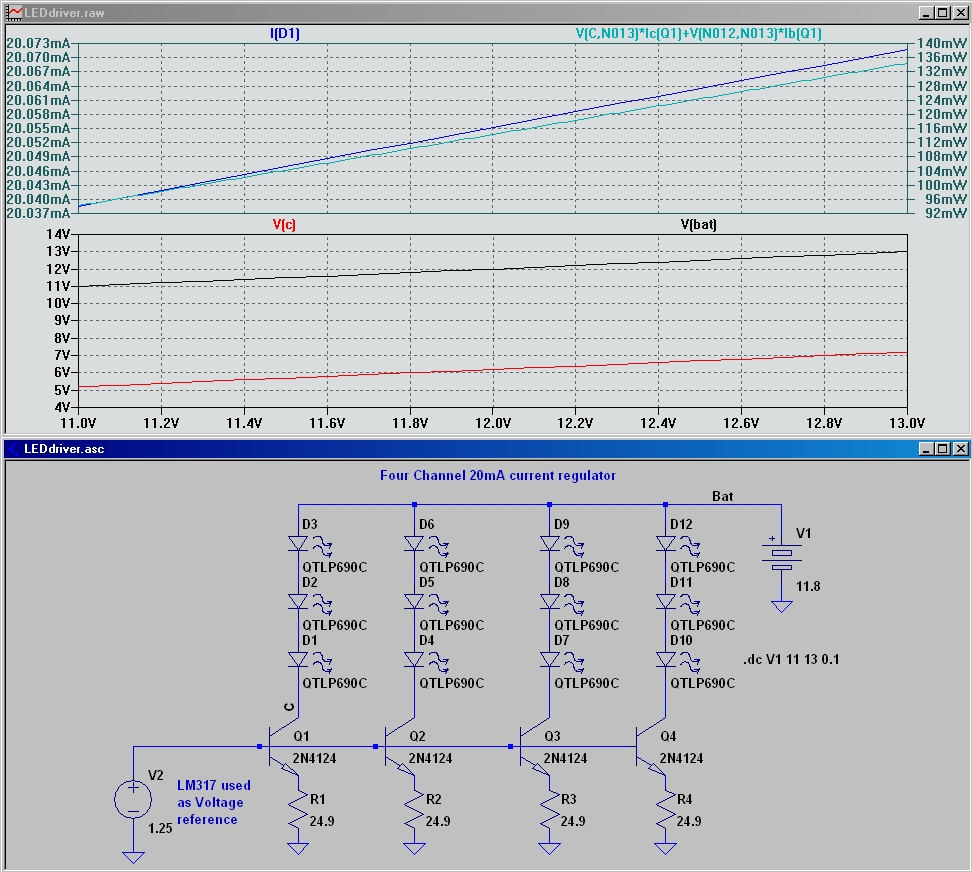

Actually I wanted to connect 4 rows of WLEDs, 3 in series in each row at 20mA. I wanted to limit this current at exactly 80mA (4 rows x 20mA) with the cheaper circuits. My source is a 12V 7Ah battery. Please advise me if you have any idea which I can go for least cost.

It's generally best to use a single current limiting device per chain, diodes in parallel are bad enough without multiple diodes in series and parallel the voltage forward won't match closely enough with series+parallel chains. At the very least you'll need current balance resistances in series with each string as well as the main current limit.

Muni,
here is something I simulated using LTSpice. The x axis in the plots is the battery voltage. The upper plot shows the current through one of the diodes, and the power dissipation in one of the NPN transistors. The lower plot shows the battery voltage and the voltage at the collector of the transistor. Note how the difference between these two traces remains constant.
I'm using the nominal 1.25V output from a LM317 as the reference voltage which drives the four bases. The current through the diodes is controlled by the emitter resistors. The circuit will have some temperature dependence.

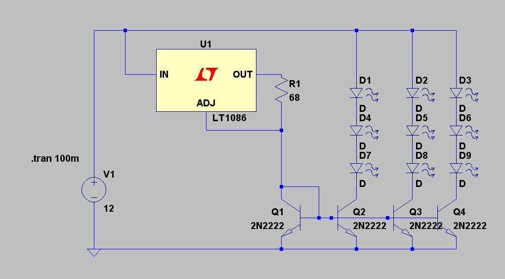

I had a somewhat similar idea to MikeMI, except I configured the NPN transistors as current mirrors. In this config, the LM317 is acting as a current source ONLY. There is no voltage regulation, only current regulation. You can allow the input voltage to fluctuate from 10.8V all the way up to 28V and the LED current will stay between ~19ma and ~22ma per string, which should be perfectly fine regulation for an LED. In this sim I used an LT1086 because I couldn't find an LM317 in the LTSpice database, but it should swap in just fine.

Thank you both, MikeMI and Speakerguy79, for your valuable information. I had used similar circuit as Speakerguy79 used but LM317 instead LT1086. I will try now with LT/LM1086 and let you know.

Did the LM317 not perform correctly? The LT1086 only has a lower dropout voltage, otherwise they are more or less equivalent.
If you're just using the LM317 as a reference, there's no point in using the LT1086 as it doesn't need to be a low-drop-out regulator.
Speakerguy, that's a great idea for getting the current source overhead out of the dropout equation. I'm concerned that the matching might not be so good in hardware. The current mirror works pretty well in an IC, where emitter areas, saturation current, thermal gradients, etc., can be tightly matched. With 5 random transistors out of a bin, it might not work so well. You could add a 10Ω 1% resistor in series with each emitter and get better current matching, with little loss of headroom. You get the added benefit of more stable current vs supply voltage.
If anyone has actually built this circuit, I would like to know how well the currents match, especially when one of the current sources has its transistor replaced with a number of randomly chosen units with the same part number. I may be all wet - but I don't think so.:D
I misread the schematic, I can see what's happening now, it's a current mirror, not just a using the LM317 as a voltage source.
You are right Roff, the 10ohm emitter degeneration resistors would be a good idea. I was honestly wondering how much of an effect beta would have, as I've never bothered measuring it within a batch (honestly because good people like you point out that an emitter resistor would be a good idea, and make the design a lot more independent of beta :) ). There are also more complex type current mirrors that are more beta independant, but that would add some additional transistors.

I don't think beta is nearly as important as Vbe matching. I'll run some more sims. The sims I ran only varied Vbe (which I changed by varying m, which is the emitter area multiplier.
Well you are working harder at this then and know more than I do :) I have long since forgotten device modeling like with the hybrid-pi model and whatnot. I just though the basic current mirror idea was an easy way to not have to worry about voltage regulation and set the current at the same time.
For transistors with identical characteristics except for emitter area, the diode equation will predict current ratio as a function of ΔVbe. This is fairly accurate for multiple monolithic transistors, but there are two other variables (Is, N) in the equation that make it tough to use it for discrete transistors. Simulations are pretty good at predicting potential problems, but there is nothing like hardware to get the real answers.:)
