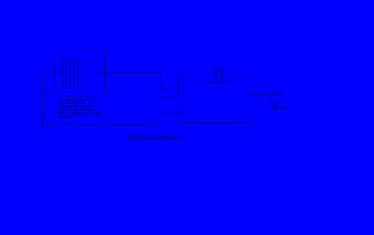

:confused:I am making a serial HHO generator and I need to know how I calculate a limiter capacitor to control the current that goes to the cell. The cell takes 12 amp at 125 VDC from a full wave rectifier that is fed from the ac 125 VAC with a serial ac capacitor and there is where I need to limit the current to the rectifier or it will be destroyed. Thank you in advance.

Use a 400v cap. 200v units make a "bang" sound very quickly even though the peak value of 120v rms is only ~170v.
At 12 A you might need to take ripple current rating into account.
Z of 1 µF at 60 Hz = 2653 Ω, reactive.
So, if you want to drop X volts at 12A you need a Z of X/12. If X is 48v, then you need a Z of 4 Ω, so that's a cap of 2653/4 = 660 µF.
You'll need an electrolytic cap, and they are polarized, so two 400v, 1300 µF caps in series may do it.
Might be some bucks.
Maybe you should use an inductor; Z @ 60Hz = 377L, where L is in henries. It would then be 4/377 = 11mH.
Don't forget that reactive ohms are at right angles to resistive ohms, so if the load is resistive you're going to need to do some vector math.

A series capacitor is a fairly poor choice for current limiting. In fact 110V as a whole is bordering on insane to try to moderate in an electrolytic cell. It's much higher than the voltage needed and there's a serious shock hazard by putting line voltage straight into an electrolytic cell.
What are you trying to accomplish? "HHO cells" being free energy or whatever is bogus. They make hydrogen and oxygen, the energy stored in H2 + O2 is less than the power draw off the outlet. People still put out plans and make claims, but no it's just a scam.

Hero999 I’ll take your opinion in consideration, thanks. Mr. Oznog, what I am trying to make is as I said, a HHO generator for welding and brazing is not a free energy gizmo. I have read that one of the best HHO (Brown gas) generator design is based on serial cell connection and it limited the necessary current by mean of a serial capacitor. I am preparing a drawing to show what is what I really need. Thanks.
Hi, here is the basic diagram without the sensors and associates safety control circuits, the cell capacity at rest is about 2,200 uf. This capacitance will varies with temperature, gas pressure etc.
