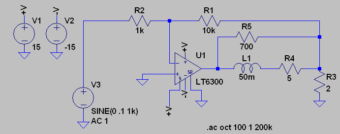

In a vertical deflection amp I often used a 1 ohm (more or less) resistor on the cold end of the coil to measure current. That is where the feed back comes from. You want current not voltage in the feed back.
If you give me the current (p-p or pk or rms), coil resistance, coil inductance I can work something up. Also I want to know what type of signal you want on the input. square/saw tooth/etc and signal size.
---edited----
Do you need accuracy! or will a little temperature drift be OK. (wire temperature of the coil)
I just picked a amp. Not like yours. R4=wire resistance. R2 to measure current.
R1/R2 points at 20db gain .
BUT the amp sees R3 and R4 so it must make 30db of gain at DC.
L1 "opens up" at high high frequency. So the gain starts out at 30db at 0 to 10hz. 45db at 100hz 65 at 1khz 65db at 10k.
So the higher the frequency the more voltage gain is needed to get a signal through L1.
Now place the amp's gain/frequency curve on top of this. Its gain is very high at DC and at some point starts down and hits zero at some high point.
When the "gain we need" and the "max gain of the amp" cross the circuit will be unstable, at that frequency. That is the point we need to stay away from.
R5 feeds the "voltage" back to the amp. It limit the max gain. I have used R5 like this because the coils I drive have winding capacitance and that adds more problems. (R5 dampens the winding cap) I have not tried it but I think the resistor can go from OUT to -IN and get the same frequency gain fix.
What I do is build a real circuit with out R5. Frequency sweep the circuit and watch it oscillate. OR Step it and watch it ring. By knowing where it wants to "ring" I then now what to do with R5.

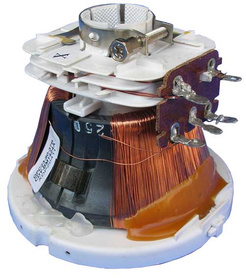

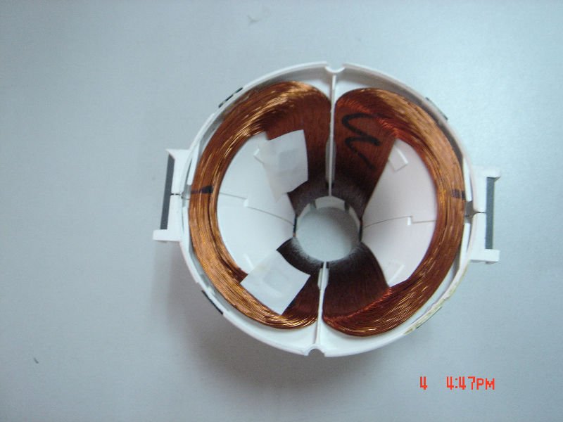

1)Below you can see the wire is wound around the core. " Toroidal "
2) This coil is not wound around the core. "saddle saddle"
My old sig gen could well be out, the 34mH coil dips at 9kc, the 60mH coil could well be 4.5kc I didnt bother being that precise.
I approximated the current consumption from the input power on my power supply.
The yoke potting goop is semi transparent, I'm pretty sure theres no core, looks like the coils were wound on a former then caked in epoxy, obviously the two windings are different, hard to say if they are similar to the yoke you posted, the one I thinking of trying looks just like that one, when I used that kind on my last vector monitor I rewound the vertical to get it so's I could increase the frequency response.

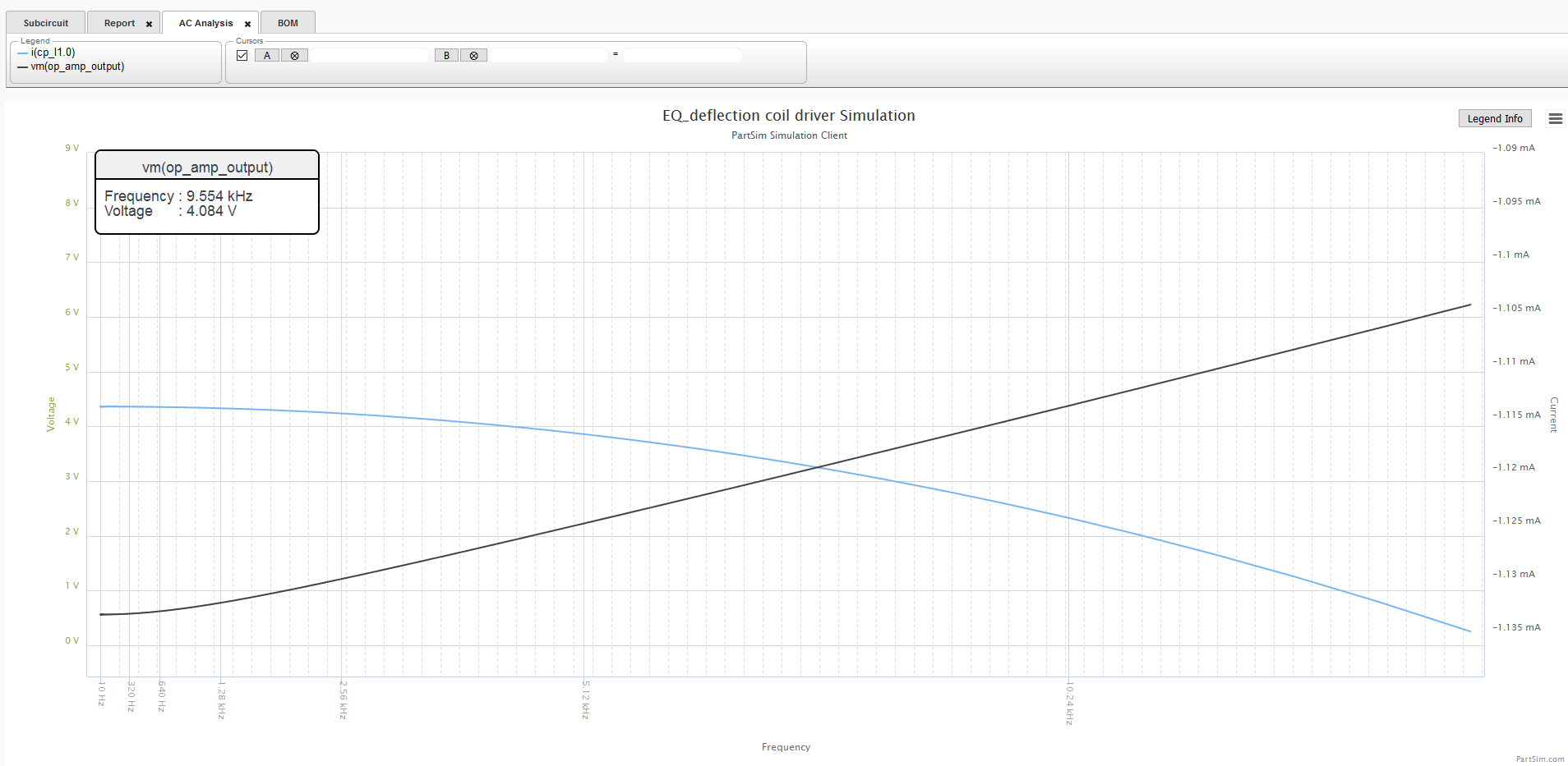

I fiddled around for a while with the sim, I changed the i/p resistor to 100k for a gain of 0.1, then replaced the current sense resistor with a 470r.
I now get 1ma through the coil with an i/p voltage of 5v, as you can see on the chart which goes from 10hz to 15khz the current through the coil only changes by 20ua over that range, drive voltage at 10hz is 0.5v and 15kc its 6v, jst above 15kc theres a goofy resonance thing going on, fiddling with the values got that high enough to be outa range, the circuit might need a low pass to make sure it doesnt do something funky (unless damping it works).
The sim shows the coil will ring with its 200pf of stray capacitance, however a 6k2 and a 2u2 cap snubber damps that down, seems like it ought to work at least ball park.
Seems that with partsim you cant really monitor current by using a voltage across a resistor, you have to use a current probe.
