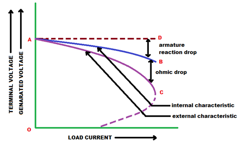

thankyou everyone for the replies but i think i have explained what im after wrong, i completely understand ohms law but the cartoons were still pretty cool, ive attached the graph where this question comes from, Why does the voltage across the output terminals drop as the current goes up? cheers guys
Simple Ohm's Law explains the voltage drop at the output of the generator when it has current drawn from it.
It has an "armature reaction" drop plus an "ohmic" drop. Its wire windings have resistance that is in series with its output. Current in a resistance produces a voltage drop V= I x R.
cheers, i understand this bit now, the more current drawn the more current running through the armature windings the bigger the Vd, how does the load draw more current? is the only way by lowering its resistance?.... if so does this mean a greater powered load at the same voltage has less resistance than its less powered brother?

When a DC electric motor runs without a load then it is not working hard. It is generating a "back-emf" which causes its current to be very low.
When it is loaded then the back-emf is reduced and the resistance of the motor becomes closer to the resistance of its windings which is very low. Low resistance causes high current.
When the motor is stalled or is started then it is not spinning so it is simply a piece of wire which draws a very high current.
