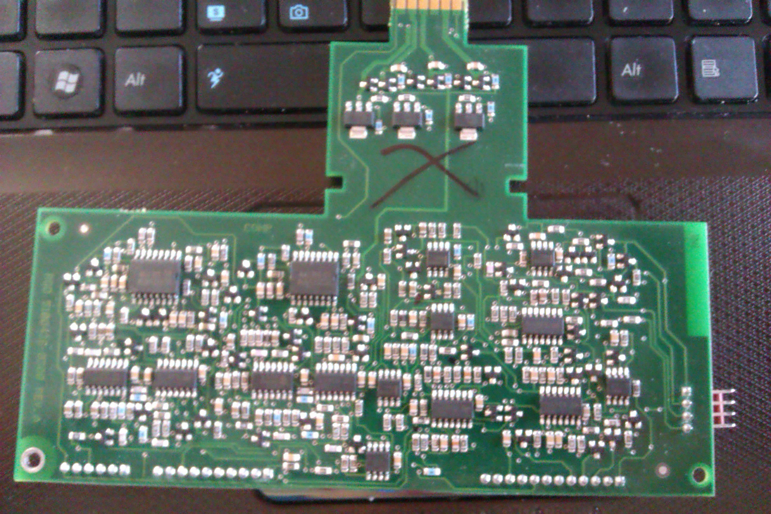

But this can be hard to do, I dont have any schematics and second PCB in this PSU, that is controlling PSU(V,A,W/P,OVP,OLP etc.), named sometimes "Daughterboard" is made from 3-4 layer PCB!
I can make only simplified schematics of some parts of PCB, excluding daughterboard(1-2 layers invisible).
This PSU is "086GNR" or "ATSN MODEL 7000245" PSU used in 6650 Dell Servers.

The daughter board probably has the controller chip on it, can you see what it is?
There is a chance that the whole thing could be controlled using discrete circuitry, in which case things are difficult.
3xLM393, 358, 358A, 5x339, 2xLM324AD, 2xUC3525ADW, ATMEL252 24C02N and in transistor package 3xZVN4206
Quality of this photo is low, I will try to rent nikon 3200...
