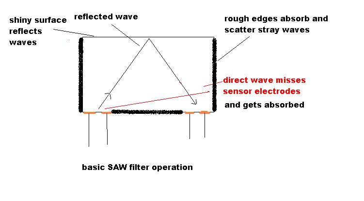

it seems it generated some freq due to the capacitance effect. Next i tried with sound resonance frequency incase i could get some feed back and amplify it, still i could not get the natural freq from a condencer mic. What kind of mic do i need to get for that? Then at least i can have a specific freq from normal rock .
a condenser mic is a "one way" piezoelectric device, meaning it has a small preamplifier built into it, and signal only comes out... it's not truly a two terminal device in the same sense as a crystal. if you are trying to use a rock as an acoustic resonator of some kind, you need an actuator and a sensor, such as a sounder and a microphone both physically attached on opposite sides of the rock. this arrangement then becomes a 4-terminal device, much like a spring reverb in the way it's arranged and the way it functions.
Forgot to mention that I used a speaker and a mic, not only mic.
if you used a speaker and a mic, you probably got oscillation in spite of the rock being there. what you would want is to have some way of efficiently creating acoustic waves within the rock, and detecting them either at the opposite surface of the rock, or to detect reflections from the opposite surface (both methods are used in SAW filters... SAW=Surface Acoustic Wave). SAW filters are made of slabs of a piezoceramic with small electrodes plated on the edges. the piezoelectric effect sets up acoustic waves that pass through the ceramic, and either are picked up on the opposite side of the slab, or reflect internally off of the opposite edge and bounce back to a second set of electrodes near the actuating electrodes, but oriented in a way that the direct acoustic wave isn't detected, only the reflection.
