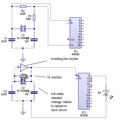

crystal oscillator
Look for 4060 IC, it's a crystal driver and divider. You have to connect crystal to it, and it produces different clocks (by dividing crystal frequency).
iv tested these i drawn them as well
