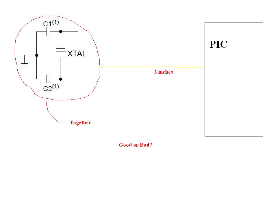

Hi 3v0, Driver300.. its a crystal oscillator and the caps will be placed next to it and these 3 elements would be at around 3 inches or less from the PICs OSC Pins. Actually i saw this guy with an arduino doing this debug thing using the serial port and i thought why not have a development/debug/programming target board for the PICKIT2(use its hardware debug capability) that gives access to all the PICs pins (has got female headers to insert wires) and allows for debugging in the circuit via a dip switch. I know i can have the oscillator right next to the PIC if i make separate boards pin wise(40, 28, and 18) but i thought if i could have the oscillator further away than i could make a general board for most if not all the PICs. Will upload a schematic and the art work to better explain it later today :)

I guess the verdict is already in, putting a crystal 3 inches away is a bad idea(even with the caps near it right)?

Yes, it is generally a bad idea to put a crystal that far from the inverter that makes it oscillate.
The wires will pick up signals from each other and from the components and tracks that they pass on the way. The ground voltages won't be the same at the capacitors and at the PIC.
I suggest that you buy an oscillator, they are not expensive, or make one with two inverters, plus the crystal and the capacitors. One inverter is the oscillator and one is the buffer. The buffered signal can be sent much longer distances.

explains how oscillators start up. They really don't like noise when starting up, and start-up is slow compared to the rest of the circuit. During start-up, the signals are minuscule. The crystal amplitude increases exponentially until the oscillator circuit limits it, and so for the first 0.2 ms the amplitude is undetectable with an oscilloscope. The only reason that I am fairly sure that the signal is there and is getting bigger is that it eventually (0.5 ms or so) gets large enough for an oscilloscope to see, and shortly after that hits the circuit limits.
I think it's a bit like starting a fire. A match will light a forrest fire, but it takes hours to go from striking the match to an inferno, and in the first few minutes the fire is tiny and can be snuffed out easily.
In the first few hundred microseconds of an oscillator starting, the signals are small and feeble and delicate, and can be overwhelmed by the big nasty, noisy digital signals nearby, especially if you add a pair of 3 inch long ariels.

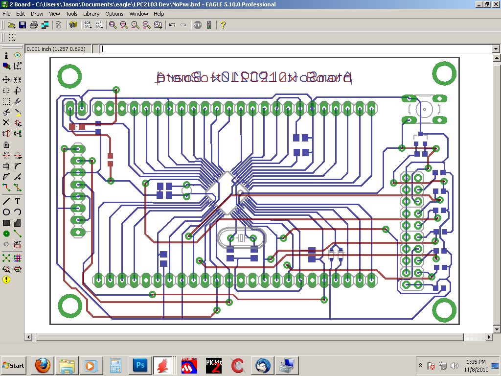

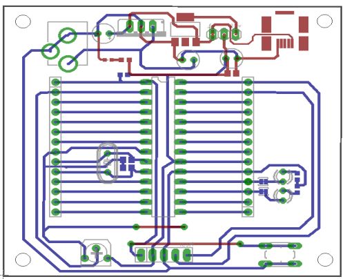

Yeah i have made tons of boards. Where the pins are nice and close here are some images. Hope they can give you a idea.

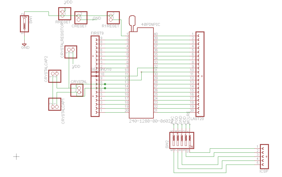

Hi 3v0 and jason, it would be my pleasure to share this. Here is the schematic, still working on the different combos about the oscillator and reset circuit types with jumpers and than will do the artwork part. It is supposed to work with all oscillator types and reset configurations, allow debug and programming without disturbing the circuit. I will add another header thing for PICKIT2s UART tool. When ever one needs to use an external crystal just place the crystal and the caps in the right female header and one is ready to go.
