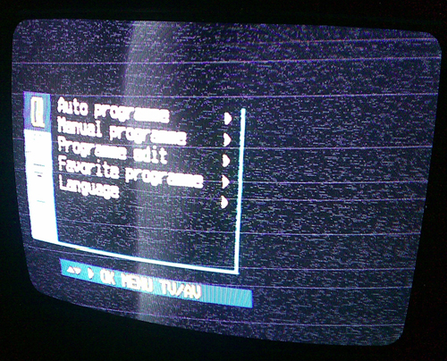

I'm trying to repair a LG CRT TV witch turns off (standby mode) withing few seconds after starting. Wired thing is this happens only if I have inputted video signals trough A/V inputs or if I have plugged in my antenna cable. Menu is visible and working fine without going to standby mode. Default blue screen also working fine.
Additionally pictures are very dark and cannot see anything until I august the G2 control (Menu and the default blue screen is visible without adjusting G2). But this cause horizontal lines and a big vertical faded line to be appear like following image.
Please help me to find the issue for this. Thanks!

The lines in the back ground are typical when G2 is turned up.
The vertical and horizontal section seem to be working.
The video amplifiers look like they are working.
It goes in power down mode when you give it a signal (antenna or A/V input). It works with a menu. Are there other inputs that work?
Who do you get to "Default blue screen"?
It acts like it is not switching from one input to another. If it does not find a sync signal (video) it just powers down.

Thanks for the reply. If there is no input signal, it's going to a blue screen like most of modern TV's. This blue screen is not turning off the TV.
Basically just only menu and the blue or empty screen with dots is working fine without going to standby mode. That happens only after inputting a video signal (A/V or Antenna)

Shutdown in CRT televisions is generally caused by a high voltage problem or ripple in the high voltage. It can also be caused by excessive beam current on the CRT. Could the shutdown be a symptom of the G2 turned up too high?

The OP needs to source a diagram...from somewhere...otherwise we will just be guessing here. And that's no good/help.
Some sets I see here do indeed shut down if a fault is sensed by the Micro or Jungle or combination thereof. Line stage is normally shut down...set goes into standby.

... and he needs to concentrate his troubleshooting in the blanking circuit/G2 level
