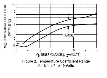

Hero999 said:
Use a 5.6V zener and a potential divider. 5.6V zeners are more stable the avalanche and zenner effects cancel each other.

A 5.6V zener has about +2.1mV/C tempco.
Therefore one can make a very good and stable zener by putting in series a silicon diode which has a tempco of about -2.1mv/C.
Now the total voltage becomes 6.2V. One can buy a zener diode with the forward diode built-in and they are called temperature compensated zener diode. They are the 1N82X series.

From Motorola, I think the 5.1V wins on the attached graph.
This is what I was taught many years ago.
Some types of zener have wider tolerance than others, in critical applications (mainly military) it used to be necessary to measure them before fitting to board. Thankfully there are better and more suitable devices now but modern manufacturing has made for a tighter spec. Imagine what we paid for 1% resistors years ago, they cost just pennies (cents) now!
Les
