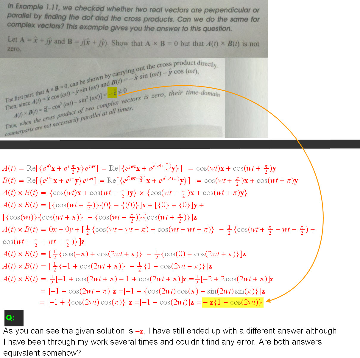

Hi
Could you please help me with this query? Thank you.

What are you trying to do there? A and B are defined already so just cross them. They contain x and y components so you end up with a z component.
I get this (x,y,z unit vectors):
0*x+0*y+(-sin(t*w)^2-cos(t*w)^2)*z
so there is only a z component left which reduces to:
-1*z
or just:
-z
Maybe you should try using the cross product more directly.
Thank you, MrAl.
I'm also left with z component at the end but my answer doesn't match with the given one. I was just being more detailed. I have been trying to figure out why my answer doesn't match with the given one without any success. If you could trace that mistake it would be really kind. Otherwise, it's okay. Thanks.

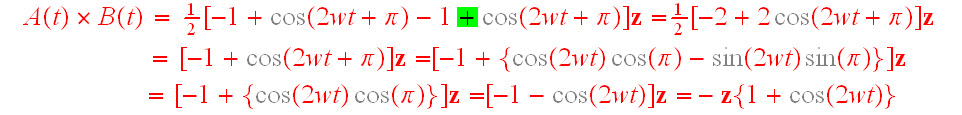

No, they're not equivalent.
You are missing a minus sign in the third line from the bottom of your working.
Also, if you use the form they've given you, i.e. A(t)xB(t) = z[-cos^2(wt)-sin^2(wt)], you can use a single trig identity (cos^2(x) + sin^2(x) = 1) to arrive at A(t)xB(t)=-z
Thank you, Doug.
Yes, it should have been minus sign instead of plus one.
