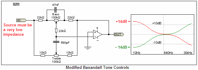

my first guess would be 10k. it doesn't matter much if it's being used in a standard voltage divider configuration. it would matter a lot what the value is if it's in the feedback loop of an op amp. most likely it's being used in the voltage divider role, so anything from 10k to 100k would work.
A standard bass and treble tone controls circuit uses 100k linear (not logarithmic) pots and boosts or cuts about 14dB with a flat response when the controls are at halfway. Here is a schematic so check the values of the parts connected to your pots to see if they are the same as this circuit:

You're not paying attention properly again AG, it's a PC 5.1 sound system, no tone controls (and never any suggestion of a tone control fault), it's the VOLUME control for the sub-woofer that's faulty.
I also don't see how you can claim that all baxandall circuits use the same value pots and components?, they vary widely depending on the design of the circuit, and obviously where you want the centre frequencies to be.
They can also quite easily use log pots as well, in passive versions rather than active ones - often used in guitar amps etc.
How can they say the tiny low-powered woofer is a SUB-woofer? It is a 5.25" little woofer powered with only 12W and the other 5 speakers are little satellite tweeters with 5W each. The controls are not shown so I assumed it has bass and treble tone controls.
Since the highs have a total of 25W but the lows have only 12W then the little 12W woofer must be a one-note boom-box that many people will want to turn down with its own volume control.
