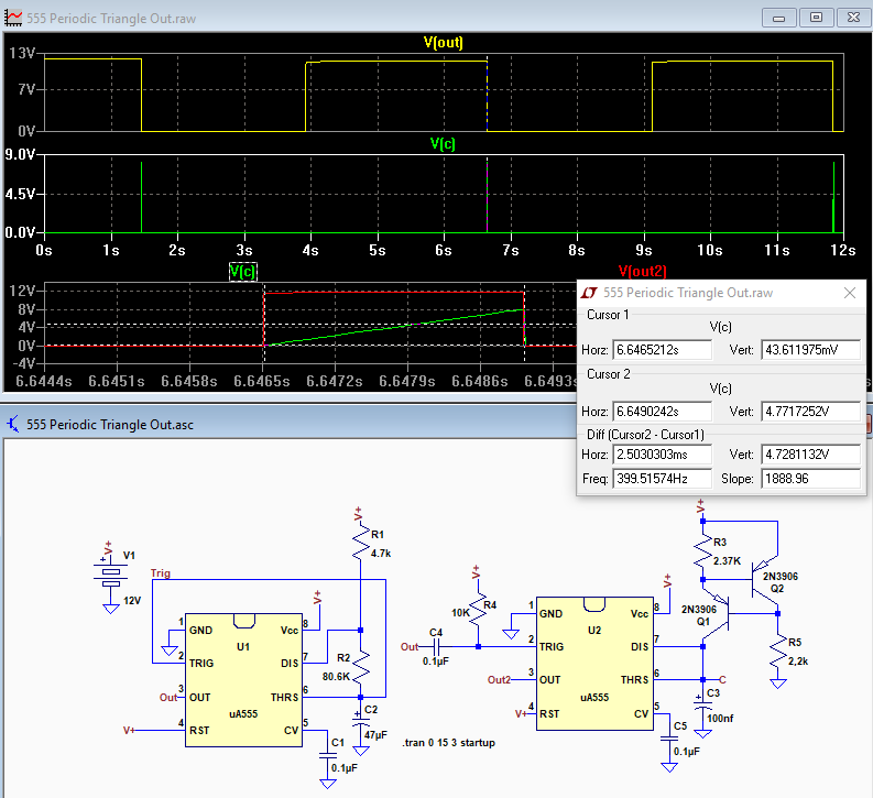

Hello, i have a 555 timer circuit that output a single pulses\ only on period, of Sawtooth signal when im pressing a button . what i want to do is to have a another circuit that can revesre those on period pulses. if some has a new circuit that generate a reverse sawtooth with one periode signals its also ok.
Thanks for help.
Your description is not very clear. Please post your circuit so we can see what you mean.

Thank you for your answer. im sorry that i wasnt clear. the width of the out put is 2.5ms and the duty cycle is 0.00049%.
the ciruit made by crutschow.
