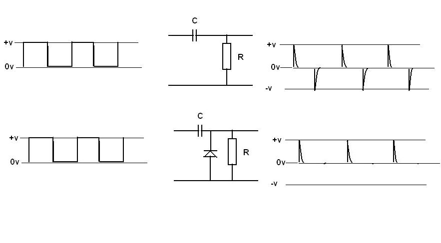

Is there a simple way to create a sharp trigger pulse from the leading edge or the trailing edge of a square wave. I recall a resistor and a capacitor connected, but I don't recall anything else.
Yes. A series capacitor and a resistor to gnd. The capacitor couples the edge through, and the resistor resets the coupled signal back to gnd.

If I put the resistor to Vcc then the trigger would be the opposite polarity. How do you select the value of the capacitor?
See the attachment.
Make the time constant CR small compared with the period of the square wave, and you will get +ve and -ve pulses as I have shown.
If you want just +ve pulses, add a diode, as shown in the second pic.

Yes, as Jim B posted. You want a simple "Differentiator Circuit". That is the name.
