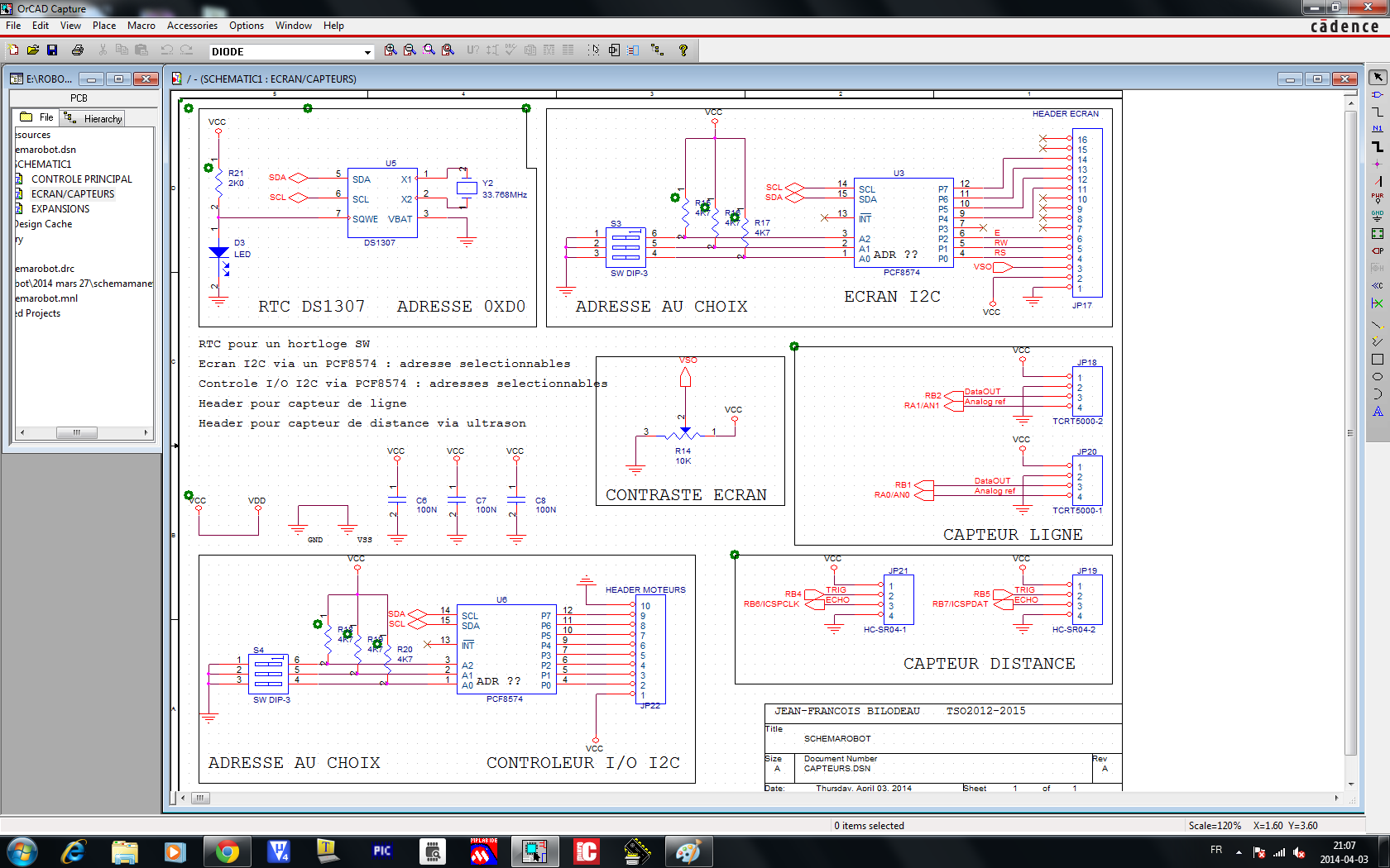

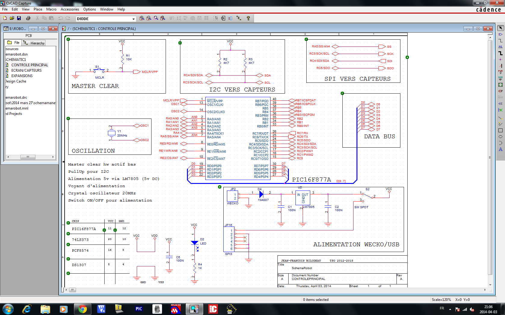

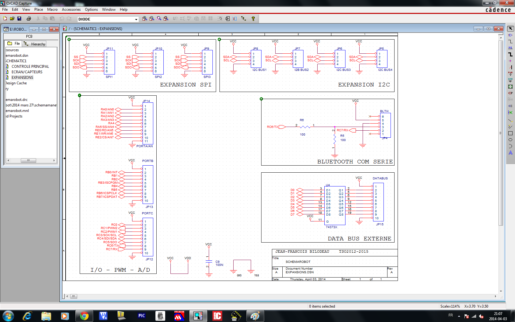

Hello everyone,
I need you help. I'm actually building a development board around a PIC16F887A. It'S main purpose is, for a teacher, to teach to new students
programming basics and more advanced stuff like Portways (i/o), I2C, SPI, DataBus, PWM, ADC etc. They're actually using 8051 based MCU, so I thought PIC family was a good alternative as it's compiler is free and there's a good community built around it.
I've got quite few peripherals on that board, but I want your opinion : what a perfect development board should have?
Thanks!
