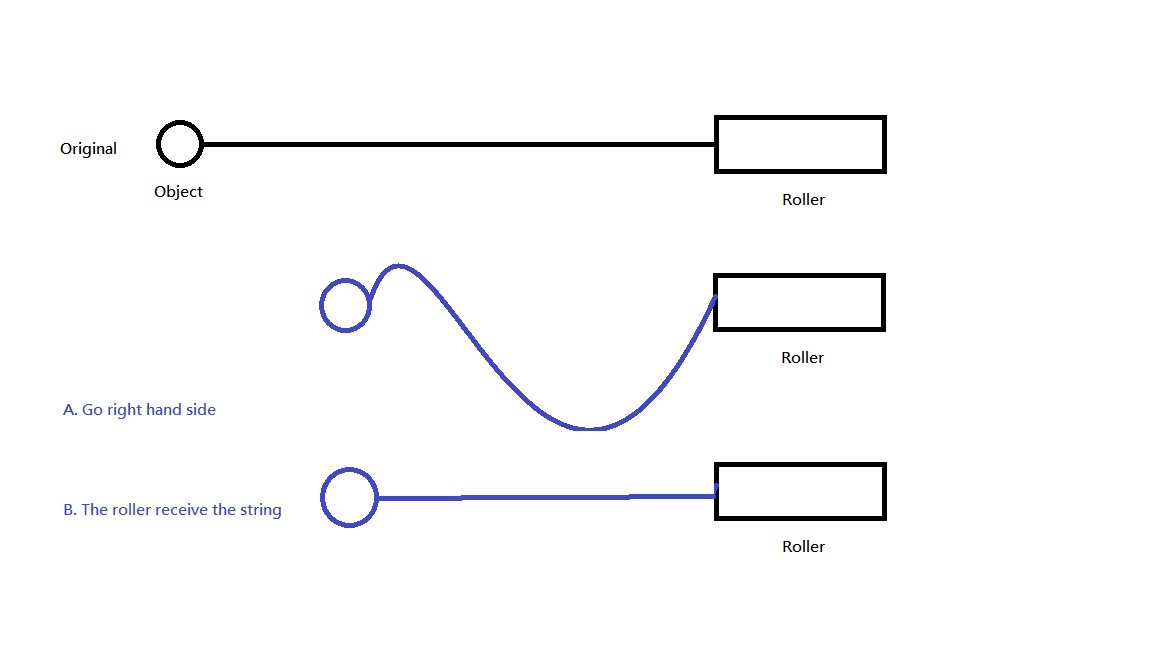

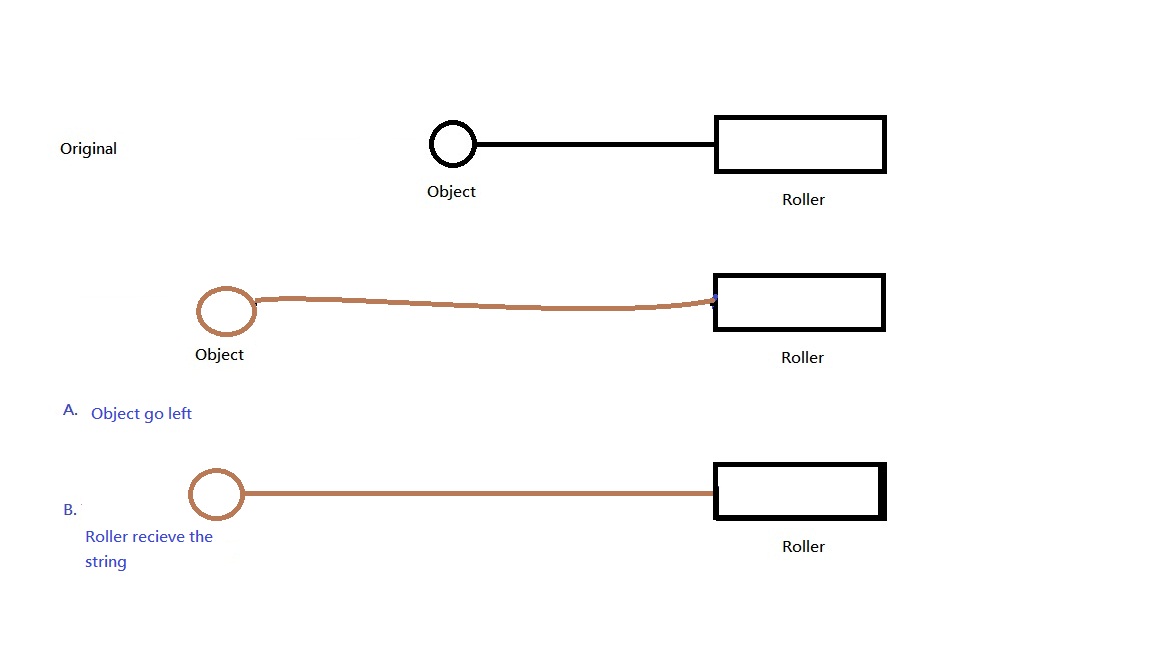

Hi all,
I am think of a project related to the tension and the effect shown below:
An object attached to a string roller:
1.When the object go right (forward), the strings will be retracted.
2. When the object go left(backward), the strings will be released from roller
When Stop, roller can spin anti clockwise direction for keeping the tension
Case 1
Case 2
For doing this, a motor attached with a roller head will be used as roller and using arduino for programing.
However, which types of sensor should be used to detect the tension or the movement of object?
Thanks.
I think you can monitor if the string is in tension with the motor current. When its gonna rise too high the you will know the motor have difficulty rolling the string back which means its already on high tension. If the current is low it means the motor can roll it more and tension is not high enough.
So, case one, the object is in position, roller not working, it might periodicaly try to roll the string back to, if the object is anchored somewhere the current will rise too high and the motor will be shut down . When you go to right hand side the periodic check will see that the current when starting motor is not rising too high so it will start rolling it untill the string is tensed and current again is too high which means the motor has to be stopped.
In case two same mechanism can be used to roll the string back (if current to high, the motor is blocked, no more rolling back) and the MCU will check periodicaly with motor if the string can be rolled back more. During the peroids where there is no check there will be moment when there will be no voltage on motor allowing for free rotation, its a moment for possible moving the object to left.
