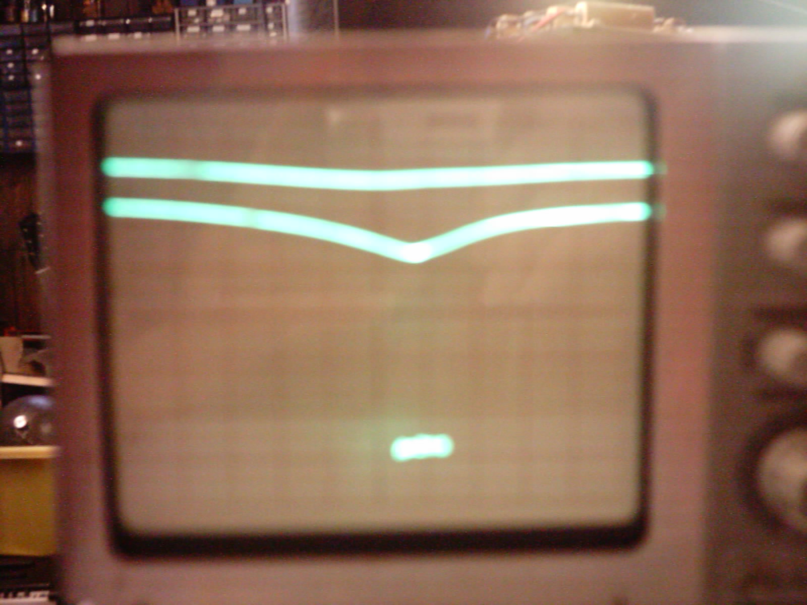

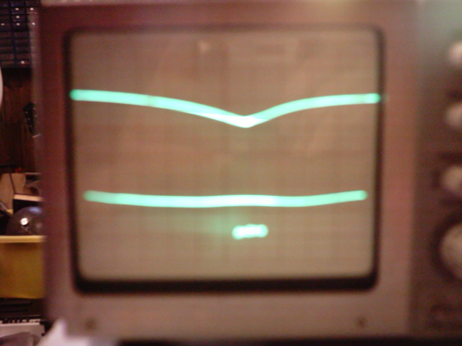

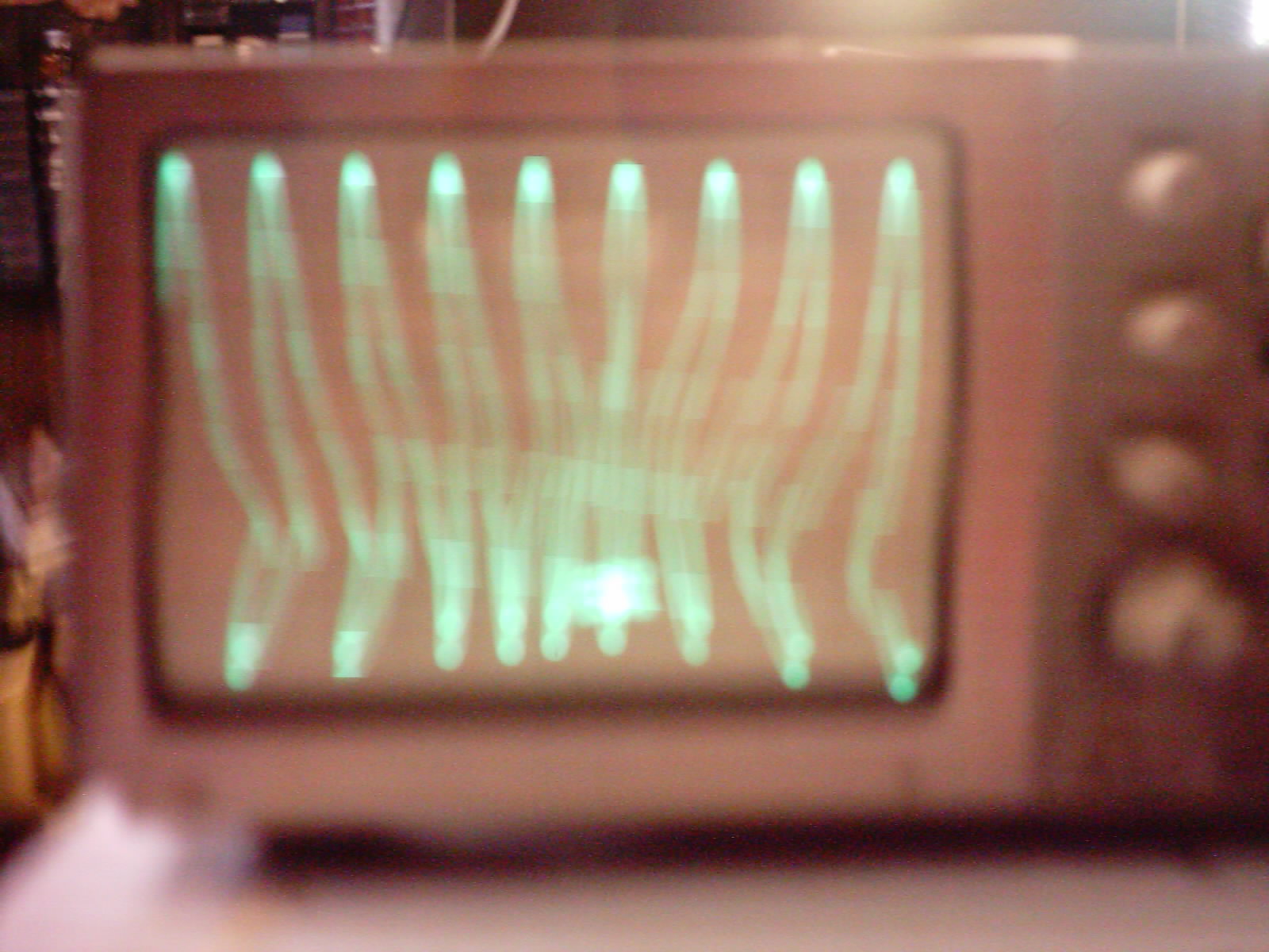

Yesterday my scope was working fine. It went out in the car boot to do a job, and was working fine then. I turn it on today, and first I suspect that I'm too near some big magnets. Both traces are bent into strange shapes.
Not magnets. I look at the timebase with the other scope. Linear.
The distortion looks like something in the tube, the effect itself seems fixed with respect to the face of the tube. On a slow scan, both traces can be seen to wobble across the screen AT DIFFERENT SPEEDS, and at one point to actually STOP. (that,s one point each, not at the same time)
I'll go and take some photos, (and another couple of those little green tablets).
A few pictures of it...
Now,the question is, what the hell happened to it? I don't remember hitting a bus......
By the way, that's a nice sinewave.

I would agree, it looks magnetic, but what is that solid bar at the bottom. It looks like a paddle from a tennis video game ?!

The blodge at the bottom is the on-screen display, suitably out of focus on my toy camera.

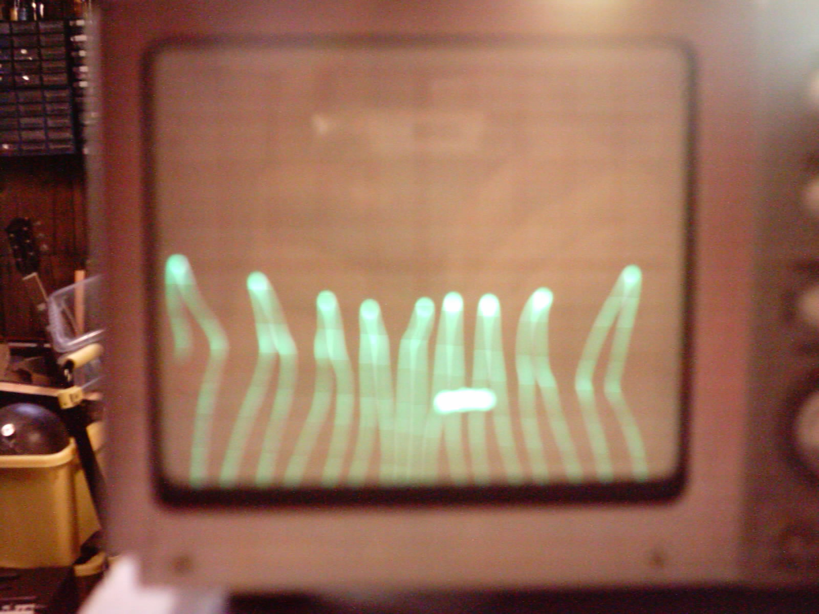

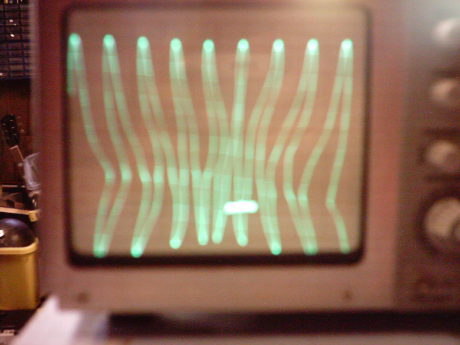

This is a faster sinewave, gives a better idea of the shape of the anomaly.
I've tried tilting the scope about and laying into it with a small rubber mallet, but it doesnt seem to shift anything.
I hope for a rational explanation.

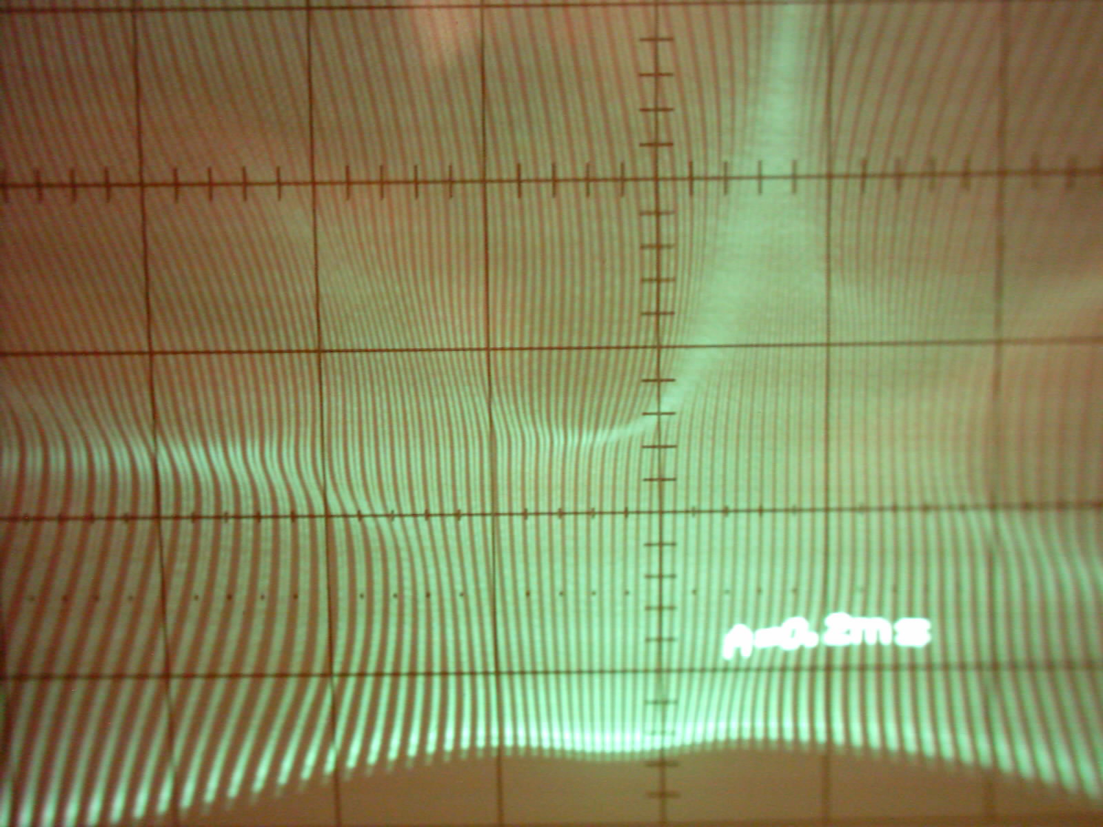

Another clue, if you put the scope well out of focus, there seems to bbe the shadow of a mesh on the screen.

That 2nd picture really brings out the detail in the problem.
The distortion has a pattern visible in both X and Y directions. This would mean any electrical fault would need to involve a coupling between the X sweep and Y deflection circuits.
Because these are distinctly different parts of the electronics, I would agree this appears to be tube related. If it is electrical then it must be somthing fundamental to both circuits... e.g ground ref. or voltage / PSU.
Can you open the scope up and check the tube for obvious signs of fault ?
