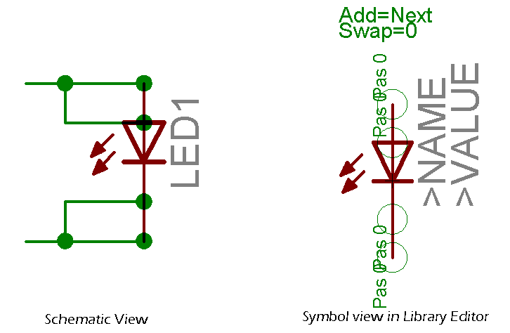

Hi all, im having a slight issue with some leds. they are the superflux type with 4 pins. in the schematic mode they appear as a standard two pin led so i connect them up. When i switch to board view only two of the four pins get connected. I cant manually connect them in board view, it says i must do it in schematic view first?

The symbol used for that device has overlapping pins since each pair of pads is electrically connected. I was able to figure that out because I opened the device in the LED library and noticed the symbol used multiple overlapping pins. You can see this in the picture labeled "symbol view in library editor" in the attached image. If you connect the part in your schematic as it's shown in "schematic view" in the attached image, it should work the way you want it to.
