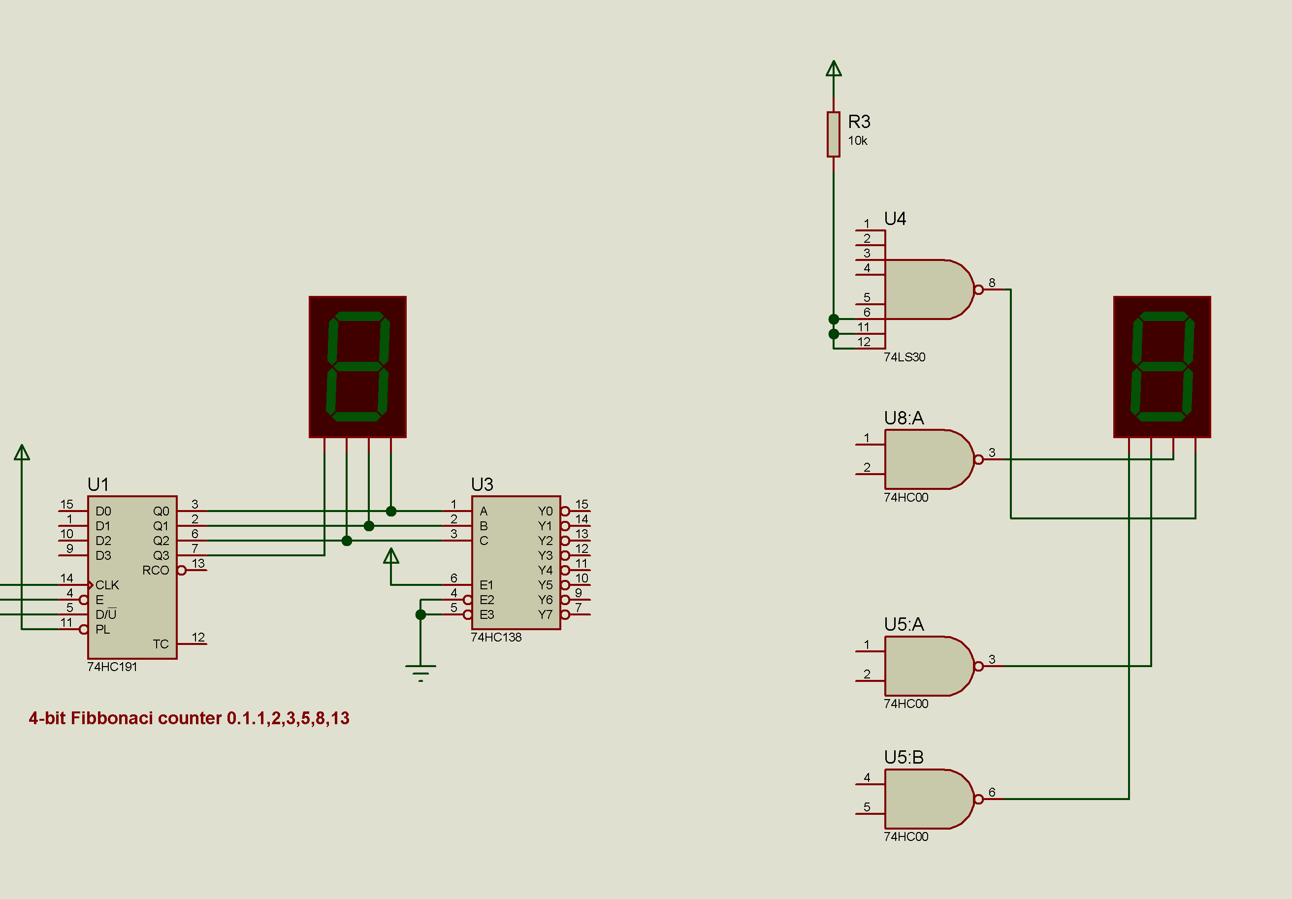

Hello again,
The circuit would look like this...
Use the counter counting UP. Using outputs A,B, and C, ignore D. So now A is LSB and C is MSB. Doing this means that the count will repeat without doing anything else.
Run those three outputs to the 74LS138 chip. You'll also have to look at the data sheet to see which other inputs have to be set to allow the 74LS138 to be enabled all the time. That's part of your job.
The outputs of the 74LS138 are inverted, but we'll call them y0, y1, y2, etc., up to y7. All the outputs are high except for the one who's inputs to the device are that outputs binary code, so when the counter is in state 0000 binary, only the y0 output of the 74LS138 is low, and when the counter is in state 0001 binary, only the y1 output is low, etc., so when the counter is in state 0111 binary, only the y7 output of the 74LS138 decoder is low.
So we have all 8 possible states decoded into a single output line with the 74LS138.
Next, we use NAND gates to generate the output code, which will be in the format you want. I'll use 8 input NAND gates and leave it to you to simplify this by using less input gates if you can. That gives you something to think about too. 8 input NAND gates would represent the solution for the most extreme problem, but this isnt that, so you should be able to reduce the number of inputs needed for the NAND gates to get the right output.
Ok, so we have the counter counting 0 to 15 and back again, but we're only using outputs A, B, and C, so the count to the decoder is only 0 to 7 and back again to zero. Those outputs will feed the NAND gates, and the output of the NAND gates will give us the required codes.
To make the NAND gates output the correct code, we look at the required state mapping:
0:0:0000
1:1:0001
2:1:0001
3:2:0010
4:3:0011
5:5:0101
6:8:1000
7:13:1011
The above is arranged in order of the counter's count, the required output, and the required output in binary:
counter:required_output:required_output_in_binary
On the output we have four 8 input NAND gates (for now), so the last thing we have to do is decide which of the 8 outputs of the decoder go to which NAND gate inputs. The four NAND gate outputs create the four bit output, bit 0, bit 1, bit 2, and bit 3, one NAND gate for each bit. bit 0 is the LSB output and bit 3 is the MSB output.
To start, a count of 0 maps to an output of 0000, so that means output y0 doesnt connect to anything because with no inputs to the NAND gates (assuming all unused inputs pulled high) the output state is 0000 also.
Next, a count of 1 maps to an output of 0001, so that means y1 connects to an input of the LSB NAND gate (bit 0). This means when the counter is in state 0001 the output is also 0001.
Next, a count of 2 maps to an output of 0001, so that means y2 connects to a second input of the LSB NAND bit 0 gate. This means when the counter is in state 0010 the output is also 0001.
Next, a count of 3 maps to an output of 0010, so that means y3 connects to an input of the next NAND gate (bit 1). This means when the counter is in state 0011 the output state is 0010.
Next, a count of 4 maps to an output of 0011, so that means y4 connects to an unused input of the bit 0 NAND gate and also to an unused input of the bit 1 NAND gate, so that when the count 4 appears on the counter we get both output bits 0 and 1 high, for a code of 0011.
So following that pattern, we get the required output codes. When the counter gets to 7 it goes back to 0 so we get the same thing again without having to manually reset the counter.
See if you can follow that procedure, and see if you can reduce the number of inputs required for each NAND gate as well as the total number of NAND gates required for this solution. You should be able to do both.
Draw up the circuit and post here and we can take a look.

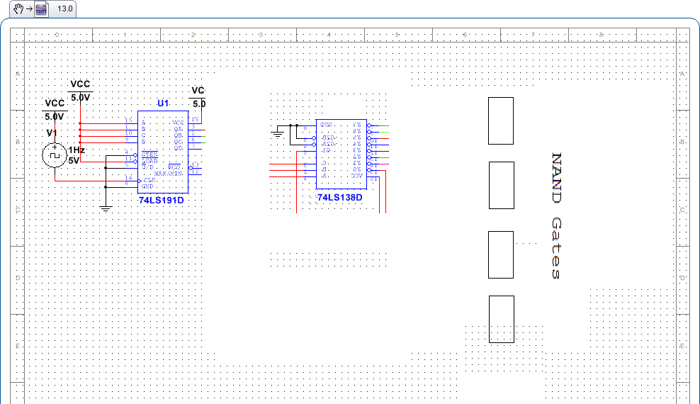

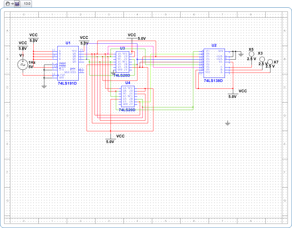

I have uploaded the schematic diagram.
Hello again,
0:0:0000
1:1:0001
2:1:0001
3:2:0010
4:3:0011
5:5:0101
6:8:1000
7:13:1011
Next, a count of 2 maps to an output of 0001, so that means y2 connects to a second input of the LSB NAND bit 0 gate. This means when the counter is in state 0010 the output is also 0010.
Well you are going to have to explain what that schematic is because that bares no resemblance to the schematic i suggested. What i suggested was a neat and orderly process to obtain the correct output codes. What that schematic looks like is a mess of connections and i dont even see where the outputs are. So maybe you could explain a little about what you were trying to do there.
The schematic i was talking about is partially drawn in the attachment which shows only the basic parts not all the interconnections.

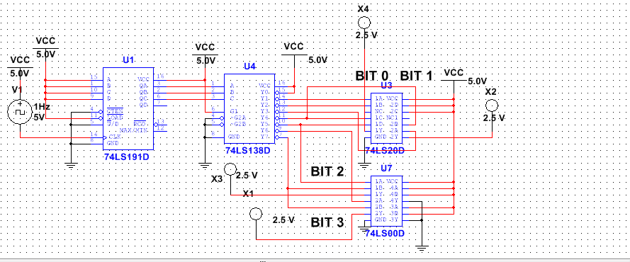

A "data selector/mux" makes it easy to "cheat". It's a great way to eliminate lots of logic.
With the chip supplied you "could", for instance change some value to anything you wanted to with one bit for the input. e.g. something like the input is unchanged or fixed at some value.
Here's more clues. To be exact, you need a 5-input NAND gate and 3 dual-input NAND. I have removed all the interconnecting wires between the 74138 outputs and the NAND gate inputs for you to fill in.
If you read Mr AL's reply closely, you'll find all the informations needed to plot the wires here
0:0:0000
1:1:0001
2:1:0001
3:2:0010
4:3:0011
5:5:0101
6:8:1000
7:13:1011
Allen
For 0001: Y1 connected to pin A 0f bit 0.
For 0001: Y2 connected to pin B 0f bit 0.
For 0010: Y3 connected to pin A 0f bit 1.
