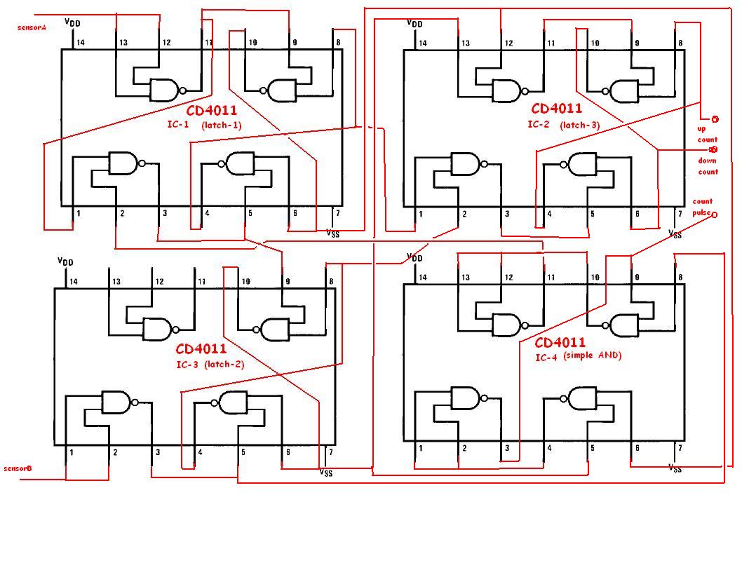

So this is how I would take a first hack at this project.
I would set up the two IR LEDs side by side. Maybe sepearted by 3" - 4". Wire them so they are on continuosly. I would mount the LEDs at the bottom of a long tube or maybe even a drinking straw. The reason is that I want the beam that comes out of the LED to be really narrow. I don't the adjacent LEDs to affect the adjacent phototransistors.
Next, I would mount the phototransistors on the other side of the door. You will have to be very careful to make sure the LEDs line up with the phototransistors for proper operation.
The phototransistors will be on when they can see the IR LED. Take the output from the phototransistor and feed them into a logic circuit. More on this logic circuit soon.
I would then feed the logic signals into a 4510 counter, connect the output of the 4510 to a 4511 and then ultimately into a common cathode 7 segment display. A tutorial for using the 4510, 4511, and 7 segment can be found **broken link removed**.
Now for the logic circuit. The 4510 has an input referred to as UP/DN. This input determines whether or not the low to high transition of the clock input increments or decrements the count. The logic signal to this input should change depending on which IR LED gets blocked first (i.e. if a preson is entering or leaving the room). According to the data sheet of the 4510, the UP/DN input pin should only be changed while the clock input is high. So this is what your logic circuit would have to do.
Depending on which LED gets blocked first the logic circuit would have to change the state of the UP/DN count or not. It should work like this:

There are several ways this logic circuit can be made and there may be easier methods but this is what I'd try first.
Very Nice!
How did u get the Logic?
So What Type of Latch is Latch 3(Set & Set) and i'm confused with Latch 2?
Holy crap dude. It's going to take me a minute or two to digest this. I'm not sure if this is how I would go about solving the problem but there's more than one way to skin a cat.
r.vittalkiran
i developed this logic for that thread, there is a small mistake in latch 3, U5C, say he top pin is enable and the down one is reset. but i used as set instead of reset since it reflect the meaning to set upcount or set down count.
about latch2, i eleminated one gate by taking its input from latch1 that is why it is confusing.
this circuit is to use only simple NAND gates, the latches can be replaced by flip-flops. the circuit has special features to disable other sensor input when one is already gives a signal. also until both sensors are cleared completely the circuit will hold the state.
also for ex: if one sensor is getting more than one signal hand or etc, it will not respond again and again, just hold and wait the conformation from the next one to make a propper count. write down the building blocks of the circuit putting blocks for latches i marked, then you can understand how it works.
you dont want to fear, assemble it using four 4011 ICs and check it will work as i mentioned. or if you can simulate do it and see.

but Mbarazeen Design may be doable...
What would happen if i keep 2 sensors very close to each other? (Using Laser)
:confused: :O
Thats what... i'm finding some difficulty in the logic part(design).
I agree and it's pretty similar to what I've come up witrh so far. If I understand what's going on he is essentialy using some NANDs as SR latches and AND gates so that the latch doesn't reset until both sensors are clear again.
Nothing, as long as you can ensure either through design or setup that the two sensors don't interfere with each other. You don't want to get false triggers because one LED or laser can be seen by both phototransistors.
what you have to do is, buy 4011 ICs 4nos & a veroboard.
plug the ICs and start soldering following the IC data sheet. it will take 30min or less for an expert to solder it out.
see the attached how it has to be connected to the pins for example.
you can have the sensors closer its not a problem, can be some 4cm or more. you have to design the sensor part to give good signal to the logic.
the out put can be fed to a counter (up/down)
not yet, but im pretty sure that there wont be any problem, if any one can have a try? other wise let me see when i find some good time.
Edit: i simulated, there is only one discrepancy when the system resets, up/down count select output (latch-3) goes to indeterminable due to simultaneous signal reversal on U5C & U5D.
but in practice there will be a slight time difference in both input signals thus it makes a time delay (may be in micro seconds) that will always set the latch-3.
all other functions are working as expected.
Note: he has to use the resistor and the capacitor as indicated after U2A to prevent any miscount during this reset.
That's what I was curious about that prompted me to ask the question. Bringing set and reset hi simulaneously will cause an indeterminent output. But I also agree with you that in real life, it will not be simultaneous. It might not be a bad idea to make one wire or trace a bit longer than the other.
I would also reccomend schmitt triggers on the inputs.
Also, if he goes with the 4510 counter, a circuit must be placed in between your circuit and the counter to ensure that the clock pulse is always high while the up/dn input is changing state.
Could maybe use a monostable 555???
i checked with the datasheet, its not necessarily to be changed when the clock is high. see the timing diagram on the data sheet. but it can be allowed to change when the clock is high and will only reflect during the next clock.
so there is no need for any additional circuit, even no need for any RC delay. semiconductor delay will play the role to set the latch-3
