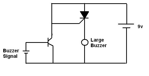

Sure,
Little embarassing, as I know this circuit is very bad, but you'll have to excuse my complete lack of reasonable knowledge!
I am using the output of the little speaker to bias the transistor, which amplifies the signal to rail, which then is used to latch the thyristor, which then applies the 9v across the large buzzer. This is what I am trying to do, but at the minute the large buzzer is just replicating the smaller buzzer signal, instead of being latched on as required.
I figured this was the method the previous system used, as the output on the small speaker must be negligible, and that alone isn't enough to latch the thyristor (rated at 1.5v). I assume there needs to be some form of resistor network in there to limit the voltage into the thyristor to something below 9v, but I'm beyond my realms of capability!
Hopefully this helps!
Thanks a lot, I appreciate it
Steve

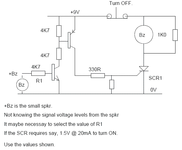

Stevie,
This circuit should be close to what you want, not knowing the voltage levels
fromthe small speaker.
Eric
That probably won't work
It's highly likely that the buzzer will turn the SCR off because it draws a pulsed current waveform. You sould put a resistor in parallel with the buzzer to keep the current flowing in between pulses.
hi stevie,
Not knowing any details on your large buzzer, Hero could be right.
Depending upon the type of buzzer, the 1K0 may be needed.
Lets Know
Eric
EDIT: In light of the OP's last post.
Hi Hero,
Sounds as though its some type of 'Electronic' buzzer, that dosnt interrupt its own supply?
Anyway, appreciate your observation ref hold ON resistor.
Thanks for the help, it is much appreciated!
After fighting with the thyristor (the pins I thought were correct actually weren't!), the circuit worked perfectly as Eric said originally! I didn't get your version Hero999 until after I came back from the workshop, so since it works, I'll leave it as it is!
