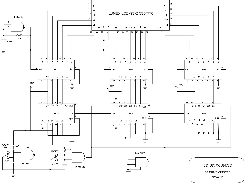

You could cascade 6 each 4510 Cmos decade counters, they are presetable and are available thru Jaycar. Here is a circuit that I built several years ago that has 3 cascaded and drives a LCD display, bu the circuit could be modified for more digits.
