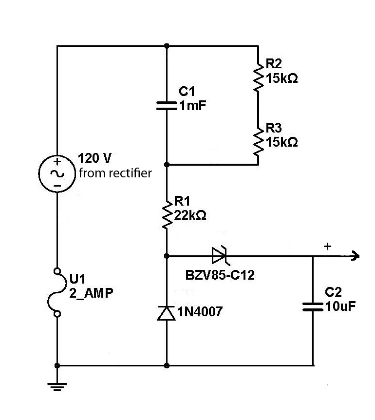

Hello,
I'm really new to this so it might be simple for some of you.
Well here is my problem I am soldering up the project described here
https://www.electro-tech-online.com/attachments/chaser-gif.57/
I used a prebuilt Full wave rectifier and got the voltage down to about 7.5 and I have the 555 chip in place with the resistors and caps all set. I hook MY DC power supply to the part and everything works great at 6VDC and 9VDC.
When I supply the 110 AC I get about 6.5 - 7VDC but I lose the pulse I was getting from the 555 chip and the variable resistor regulates voltage rather then the pulse rate on pin 3 of the chip. I'm sure I have overlooked something but I have not figured that out yet. I'm sure I will learn from it though ;-)

The 555 circuit without the transformer+rectifier?
Without the rectifier it works as it should with pin 3 sending a pulse adjustable from the potentiometer.
What do you mean by this? Pin 3 becomes a constant voltage and the potentiometer adjusts that voltage? Or there is some kind of waveform there that does not change but the potentiometer adjusts it's magnitude? What exactly?
I used an LED just to make sure that part of the circuit was working and it would flash with the transformer attached. With the rectifier though it was always on and when I adjusted the potentiometer it would get brighter or dimmer and would not do the on and off pulse. So yes it acted like constant voltage was going through it. I attached a schematic of what I did from the rectifier perhaps it will help.
Thanks again,
Ted

Could it be the rectifier output voltage is too high and the NE555 starts breaking down?

His last post shows a Mickey Mouse high voltage low current circuit instead of a more powerful circuit that uses a transformer. Its zener diode does nothing because it is backwards and is in series instead of shunt.

I didn't want to spend too much on the circuit that will only control outdoor Christmas lights, and some of the multi-function ones use the 4 diode full wave rectifier so I did not think I needed a transformer.
The rectified 120VAC makes pulsing peak voltages of +168V that you applied to your circuit.
Therefore the 555, the CD4017 and maybe the transistors are destroyed.
Of course you need a transformer to reduce 120VAC to 9VAC. When it is full-wave rectified and filtered then it makes +11.3VDC.

He didn't blow it up with a 20V supply. He rectified 120VAC then fed the +168V pulses to the the 555 and the CD4017.
He had the 12V zener diode connected wrong so it didn't do anything.
Alright well it was the Zener placed incorrectly. I replaced it and all is working like a charm. I haven't put the 4017 on yet I wanted to check the 555 to make sure that part was working before i moved on. I do have it all working on solderless project boards so I use that as a template to move it over to a soldered board. I planned on making 2 anyway.
