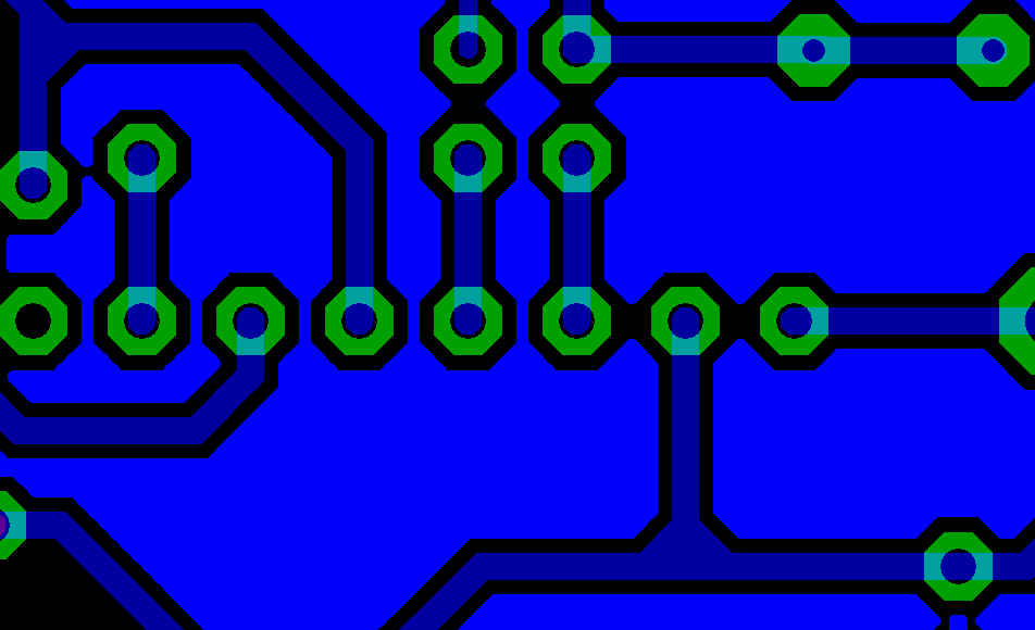

Hey everyone,
I'm designing a pcb in eagle and I made a copper pour on the bottom layer.
Since I used a rather high isolation (etching at home) I got those copper blobs which do not connect to anything between components/pads ect... (See attachment).
Do I need to get rid of them ? do they have any effect on the circuit ? (parasitic capacitance/noise whatever).
What would be the easiest way of getting rid of them ? I could do that in photoshop since I use it to invert the colors anyways.
Thanks in advance, Mike.

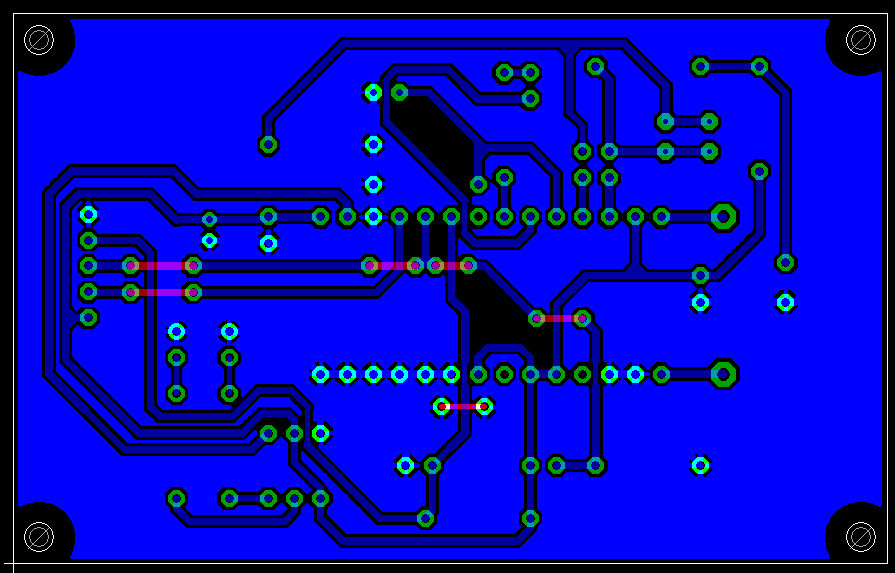

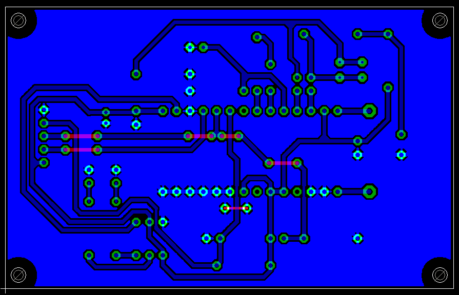

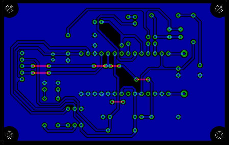

The isolated blobs are not normally a problem, expect perhaps in RF type circuits. So you can leave them there if you like.
if you want the blobs to be connected to circuit ground use a trace width of 0.254mm (0.01") and draw a wire from the ground pour into the area you want to fill with a non isolated ground fill.
Name the short piece of wire "ground" (GND) and perform "ratsnest". Ratsnest then connects the blob to circuit ground.
Please refer to the attached five screenshots.
Note the highlighted area. It's all connected to ground. Also note the difference between image4 and 5. Just rerouting of one cap improved the overall ground pour to almost 100%.
Boncuk

The "blobs" are also called "orphans" in Eagle. When you make your polygon, you have the choice of orphans on or off. Try that switch. If you already have the polygon, go to information ("i"), click on the copper filed area, and be sure the orphans box is not checked.
