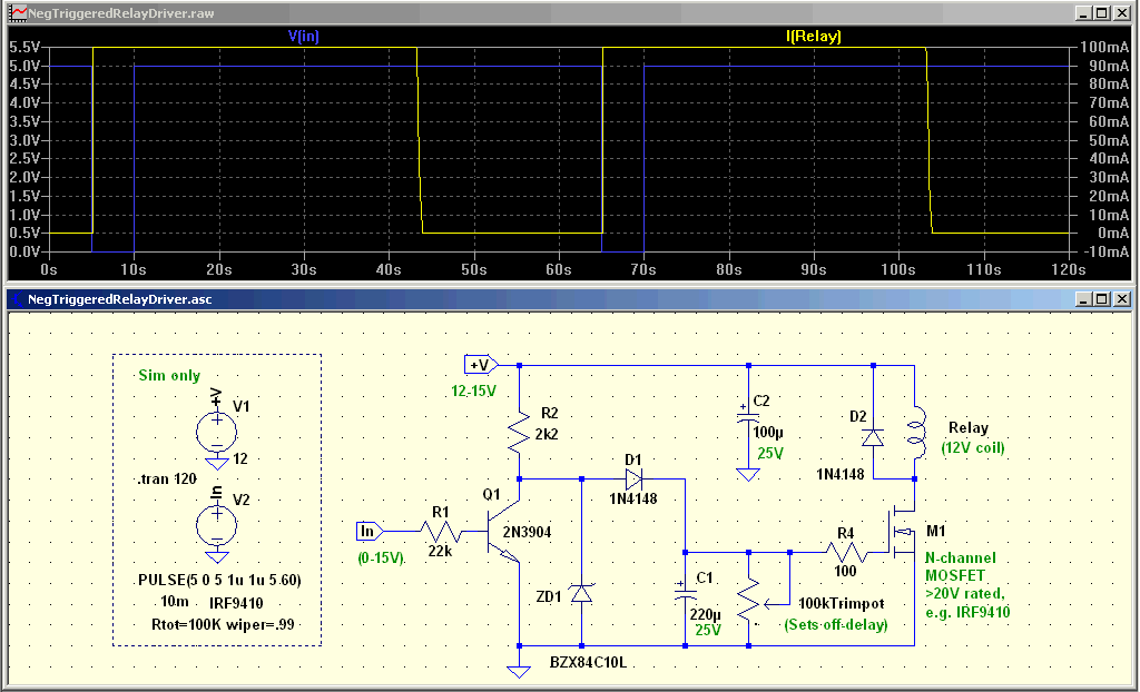

As the title states, looking at controlling the cooling fans and circulation pump in a certain manor. Now this may be long winded for something simply simple, but more info the better?
ECU outputs are for Radiator Fan 1 and 2, Both Negative switched, At the front of the car there are four relays with their terminal 86 going to ignition power, And terminal 85 heading back to the ECU (Rear engine, Front Radiator)
Three relays control the cooling fans in a Series / Parallel arrangement, The last relay controls the Circulation pump.
Now onto what I would like to see happen, the cooling fans staying in the Series / Parallel arrangement, but i would like to see the Coolant pump turn on with the low speed (series) fan trigger, But like to see it shutting off @10-20 seconds or so after the Low Speed trigger is shut off. Most simple circuits i see usually used a positive trigger, but since I'm dealing with a Negative trigger what is evolved in getting this to workout for me?
Now in my dream world, I would have it so that the Cooling fans will run on low (series) and the Coolant pump still on for awhile when the car is shut off only if the high speed fan was triggered when the car was shut off for another 10-20 seconds.

What is the voltage of your 'negative trigger' source when not triggered? Are you providing the trigger directly from the low-side switch of the fans, or from a MCU? If the latter, then a 5V source may be needed.
Are the ECU outputs which provide the low-side switching PWM-driven (i.e rapid pulses not steady DC)?

Looks like the ECU output is an open collector/drain arrangement.
I think something based on this will do what you want. The relay is switched by a FET, which has an extremely high input resistance, enabling a long off-delay with only modest capacitor values. This delay is adjustable up to about 33 sec with the components shown :

And with your Schematic the "in" with the comment (0-15V) underneath is just a ground (low?) input? Since this Schematic seems more complicated then the one on Bowdens site, is this one better?
The 'In' is the negative-trigger input point, assumed to be the ECU output for switching the Low-speed fan.
Bowden's circuit doesn't have the negative trigger that you want.
Alec_T tried making your circuit, but could not get it to work on my breadboard and trying to simulate (negative) the ECU triggering it.
Right now my bread board is populated with modified delayed on and delayed off circuits on Bowden's site, I'm just using a relay to convert the negative signal to a positive one at this time .
