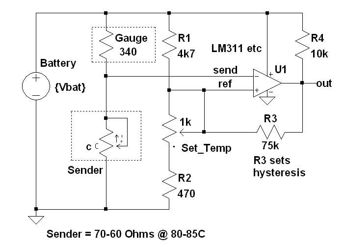

So I'm putting the previous project on hold for a bit and going to try this cooling system thing in a different approach ?
Components on hand:
LM311
VDO temperature sensor (P/N: **broken link removed**) (A NTC sensor, 17000 to 10 ohm))
The Thermostat is open at 78'C
The Cooling Fans turn on at 96'C
The Pump in my Mind should turn on around 80-85'C
With that said, and with the sender above, that would be a 70-60 ohm resistance
A built up a circuit on my bread board, and technically it is working which is nice, but i'm also using 2.5K Pots so the adjustment in the lower Range isn't that fine. also using a 10K resister on both the Reference and "input" voltage dividers. All testing had been using a 12V power supply
Still trying to figure out the Hysterysis for it too, and how to implement it to the LM311 since it has it's own built in Transistor (open collector)
Questions i have
1) Now the sender itself is also hooked to the coolant temperature gauge (Coil style? +, -, S terminals) so i'm wondering how that will effect the whole process? and the gauge itself?
2) Since the range i want the pump to be turned on is when the Temp sensor is in the 200-0 ohm range, what would be the best way to get better (finer) adjustment in that basic range?
3) If i run say a 9Volt regulator (Have one on hand) to power the LM311 and for the reference voltage should i also do that for the input too?
Thank You

The sender itself is self grounding. So only one terminal on it.
The gauge itself isn't regulated, the postive (or high) that's going into it can range 14.4volts and down, whatever the alternator is putting out.
But think of it this way. From the fuse (12.2-14.4volts) to an coil in the temperature gauge to the thermistor which is grounded to the block. So basically the thermistor is altering the magnetic field of a coil inside the instrument to counter act the other coils magnetic field to move the needle.
In a sense it in itself is a voltage divider circuit, but not sure if one and truly use it as such? The coil will be a set resistence that's tied to high, with the thermistor tied to low inbetween the two should be the voltage divider?
Or can I just make my own voltage divider tieing into the wire going to the thermistor and using say a 10k resistor to high to create a independent voltage divider just for this circuit? But would two voltage divider alter the resistance signal of the single thermistor?

OKay i have made up a circuit that seems to work, least on the bench but before heading there, i see if i can make myself less confused?
Power source = 12.32v
Power at sensor terminal with sensor disconnected = 7.5v
Power at sensor terminal with sensor connected (85*C) = 2.064v
Power Source = 14.1v
Power at sensor terminal with sensor disconnected = 8.63v
Power at sensor terminal with sensor connected (85*C = 2.37v
The information you wanted at the beginning right, KISS? I'm thinking no voltage regulator since the voltage changed on the open sender terminal of the gauge.
Also i'm not even sure if this gauge would perform correctly if i was to wire in say a 5 to 9 volt regulator, It may be just fine and i can try it out later. But i like to keep the modifications to minimal to get this circuit to work.
Nope, there is something there, not necessarily a regulator. because it's not 12 V and as predicted: 7.5/8.63*2.37 = 2.06 which is really close to 2.06 (Identical).
The output "tracks" the input voltage.

So, either, you setpoint has to "track" the input voltage or you have to "FIX" the input voltage. When you fix the input voltage, at some value, it won't work. In the DC=DC converter I found, that would be 9V. You would want a DC-DC converter that can take a maximum of 18 and any minimum <= 9 V.
A 5 to 9V regulator might work. Your choice may have a drop of 3V. e.g. an LM317T, so an Low dropout regulator might be more appropriate.
Based on the figures in post #18, here's a suggested circuit. I've attached a zip file for simulating the circuit.
The comparator receives a reference voltage which, like the voltage at the temp sender terminal, tracks the battery voltage. The trip point is thus not significantly affected by battery voltage and no regulator is necessary.
The trip point is adjustable with a trimpot. R3 sets the amount of hysteresis, so may need to be tweaked.
