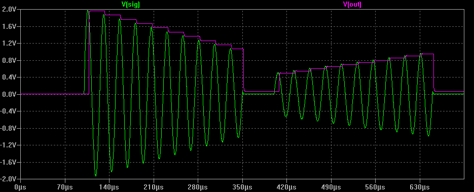

I have designed and simulated a circuit that has the output shown below. If you're interested, I'll clean the schematic up and post it.

But he's not trying to store a sine wave. He will have sample-and-held peaks that will be stable for most of the 25us period of the sine wave. See the waveform I posted on one of my previous posts.

I didn't post the circuit. I simulated one, and posted the waveform. I'm working with DSG here to come up with something "easy" to build, as regards supply voltage(s), packaging preferences, etc. I'll post the waveform again here.
Even if it's just sampling the violet waveform you should trigger the conversion with the original waveform if you want to avoid oversampling.
The 18F1230 has a DIP version.
I realize that the samples need to be synchronized with the input signal. I'll need to provide a start conversion pulse. Do you know how it should be timed relative to the waveform, and how wide it needs to be?

The pulse to start the A/D can be edge triggered as soon as the peak has been detected. The PIC can return a reset pulse as soon as it's finished conversion ~10us if needed.
Excellent. I think I already have that edge available.
