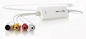

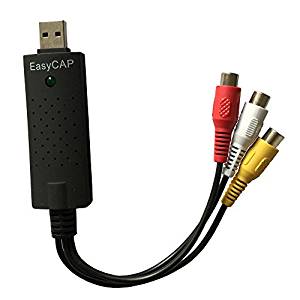

Search "Easycap" or "USB video capture"
Looks Good, But Not Available for Shipping to Canada.
There are plenty examples of that exact AV digitiser, and many of them will ship to Canada.

also be wary of the capture cards, i bought 3 before i was able to get one with drivers post win98
