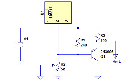

If you're desperate, you can add an approximately constant 5mA load. It wastes more power than just using 120 ohms from out to adj, but at 20V out, it's still only about 100mW.
Warning - the pin numbers are wrong (but correct for the sim).
