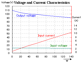

You should look at the entire project on the Japanese guy's website to see how weak his inverters are.
The first one is shown to drop its ouput voltage when the load is only 10W and has a max battery current of 3A which is 36W.
The second one has an output voltage of 110V without a load, 100V with a 40W load and 90V with a 140W load.
https://hobby_elec.piclist.com/e_ckt30.htm
