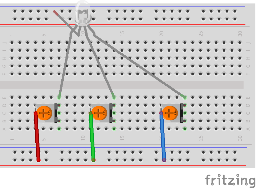

I'm trying to build a circuit to show students primary and secondary colours using an RGB LED (common cathode). Using switches gives an approximation but the colours are a bit off - eg yellow is more a lime green.
I'm trying to find suitable resistors to make it more convincing, but here I've encountered a problem. When changing the brightness of the Red component it goes from red to off and back to red again as I turn the pot (10k).
I'm attaching the circuit layout to see if this is basically wrong (I haven't really studied electronics for 30 years!)
Thanks in advance

The most likely reason the red LED goes off again is because you are not limiting the current and the die overheats to the point that the light output drops off so much that you can't see it. Either that or you have burned one end o f the resistive element in the pot. To guard against overheating and possibly ruining the LEDs and burning your pots, you really should have a fixed resistor in series with each LED. Based on the apparent size of the LED you should keep the current to a maximum of 20 ma.
The maximum allowed current for the LED is probably 30mA for each color. Without limiting the current then it might have been hundreds or thousands of mA. I bet the LED and the pot are burned out.
The power supply voltage is not mentioned. With a 9V battery and a current of 20mA in the 1.8V red part of the LED then a resistance of (9V - 1.8V)/20mA= 360 ohms or 330 ohms should be in series with the pot. The total resistance of 10,360 ohms will cause dimming but the LED will still be very visible.
EDIT: The green part and our vision are more sensitive than the red part so turn down the green level instead of overdriving the red.
The red LED isn't burnt out AFAIK. The red colour appears at the extremes of the pot's rotation (ie 0Ω and 10kΩ). The green overrides it in between (blue was disconnected).

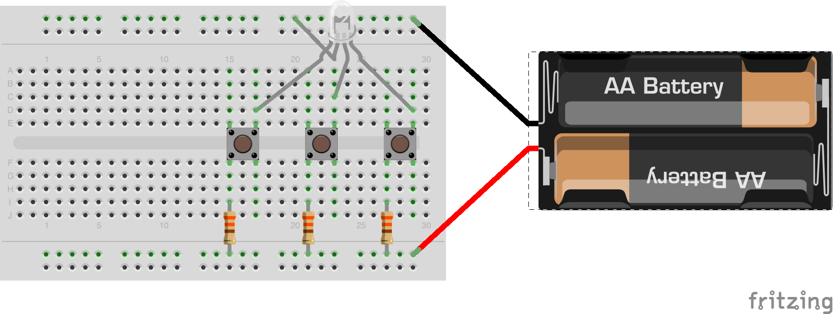

Sorry I didn't indicate the battery used - I've connected 2 AA cells, with a nominal total of 3V. My original circuit (attached) would take 9V but the colour balance was even worse.

Your color balance is bad because the pots are not connected properly. It looks like you used pushbuttons instead of 10k pots. When a 10k pot is connected properly as a rheostat then it adjusts from 0 ohms smoothly to 10 thousand ohms. Then the brightness of the LED is bright when it has the 330 ohm resistor and is dim when it has 10,330 ohms.
3V from 2 alkaline cells is only when they are brand new. When they are used only a little then the blue and maybe the green will not light because they need about 3.2V.
Which of my diagrams are you looking at? The image at the top of the thread it the current set up, with the pots. The second one does have pushbuttons. This is just to show you what I am trying to work towards. In the "pushbutton" circuit the current limiting resistors are all the same. I'm trying to use the potentiometer circuit to fine tune this, using different resistors to alter the brightnesses of the three components. I am open to suggestions!
With a 10k pot in series with a 330 ohm resistor and in series with an LED then you can adjust its brightness without destroying anything.
