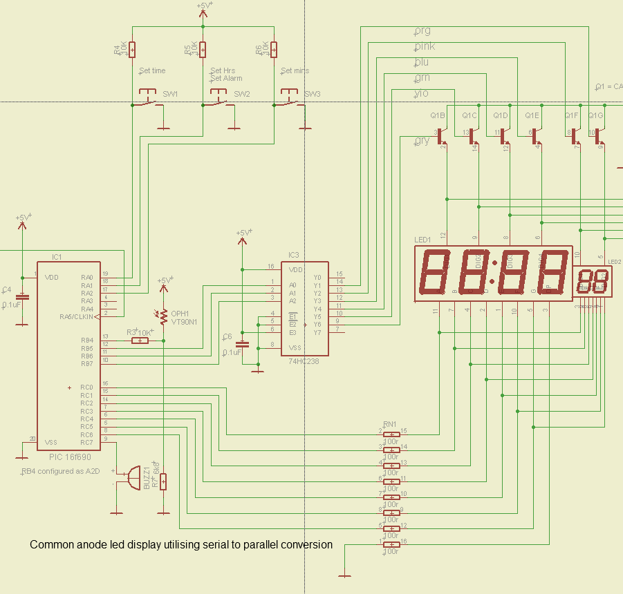

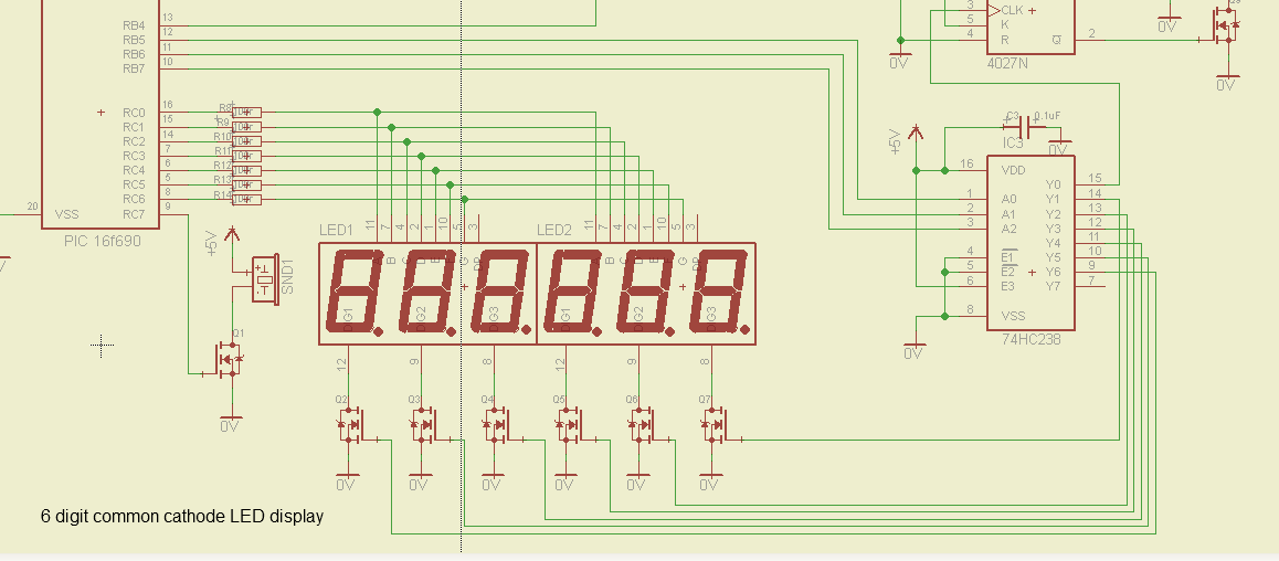

You do the decoding in your software (look up table). Not neccessary to use latches. Drive the led's at 60+ Hz refresh rate.
Multiplexing is straightforward. Put the data for digit 1 on portx and turn on that digit (via transistor or mosfet in series with digit cathode, assuming a common cathode display). Small delay, then turn digit 1 off. Put data for digit 2 on portx, turn on digit 2, small delay, turn digit 2 off, etc, etc.

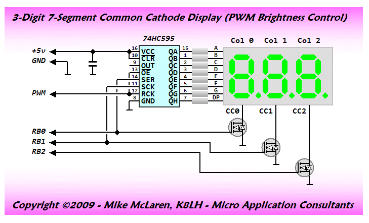

A latch IC can be used quite effectively as part of a high performance multiplex display driver.
