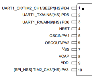

    I know it is a common question but still we cannot get rid of it. We are using stm8s003f3 in our project. An ac motor is switched ON and OFF by a 12V relay (using timer).
    The controller frequently resets itself when a relay is tripped ON or OFF. We used pf on the controller pin, pulled up the NRST pin with a 10K and a pf, used 7805 instead of lm1117, and tried a few other things, but couldn't succeed.
    It would be a great relief for us if anybody can provide solution for it.
    THANK YOU.

  9. jpanhalt
    jpanhalt Well-Known Member Most Helpful Member
    Joined:
    Jun 21, 2006
    Messages:
    6,070
    Likes:
    524
    Location:
    Cleveland, OH, USA
    The fact that it works fine off a battery and not your power supply implies that maybe the esr of your supply is too high, so you are seeing brown-out resets during periods of high current demand. You mention a decoupling capacitor and the schematic shows what looks like "p7" from pin 9 to ground, but no value is shown.
    You may want to consider a larger capacitor (at least 0.1 uF ceramic ). Some devices that are sensitive to such glitches use a decade series of capacitor values in parallel, such as 10uF,1 uF and 0.1 uF or 1 uF, 0.1 uF and 0.01 uF. I have even seen low pass filters (i.e., RC) implemented at the MCU supply pin to smooth noisy supplies.
    What value is "p7"? What value(s) did you try with no improvement?

    When I suggested a large value capacitor, I did not mean at P7. The data sheet is clear that P7 should not exceed 3300 nF. My reference to a large capacitor was to put it on the rectifier output across C1.
    I find your schematic is not drawn very well and is hard to follow. Does the primary power for the controller enter at TR1 and TR2 (13VAC)? What is I2? It looks like it might be a 5V linear voltage regulator.
    As for the pcb design, the first question I must ask is how the connections are made from J5 to the relay RL. The motor power contacts should be very well isolated from every other conductor on your control board. By well isolated I mean with no metallic contact to your board conductors or planes, no overlap to your board planes, and at least 5 mm clearance (preferably a lot more clearance) to other traces and planes. If it were me, I would not bring the motor power onto this board at all, I would use an off-board relay to guarantee good isolation.
    A 1HP ac motor, depending on what mechanical load it has, can require more than 5 kW of momentary power to start. I would use a very substantial (ie. large) relay to switch such a motor on and off.
    If the current drain of the uP alone (and its I/O) is small you can put a small series resistance and large shunt capacitor in line with the 5V rail to the uP to act as an additional filter. If your total current consumption from the 5V regulator is small, such a filter is best placed on the input side of this regulator so that it's voltage drop has little effect.

    Maybe I misread the schematic. It appeared to me that p7 was attached to pin9, which is VDD. Vcap, which is limited to 3300 nF, is pin8, and was also identified as c3.
    John
