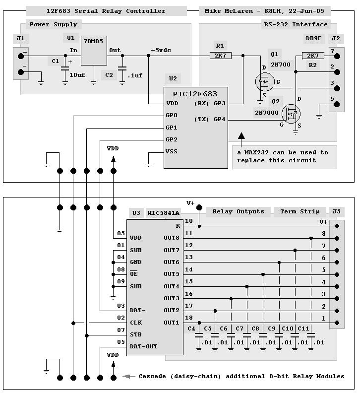

As Nigel mentioned, this project could be done with a PIC or any microcontroller... Do you have microcontroller experience?
Here is a sample scheme using Micrel 5841A drivers... If you can construct some sort of Serial Command Language then the microcontroller can interpret the commands and clock 32-bits of output data to four 5841A relay drivers before issuing the Strobe to latch the relay output data...
Sorry, I have not written the PIC code for this system yet...
Good luck with your project... I hope I may have provided you with some useful ideas...
Regards, Mike

thanks green
dear green.
i tryed this method. but i want you to lock carfully you cant exapnd the
output for more than 8 output . i cant explain it to you but i did it and
got 8 outputs only .
thanks man.
