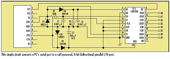

I have searched the web, but haven't found anything too promising on controlling a stepper motor through a PC serial port without a microcontroller. Could someone point me to plans, schematics, components, strategy or anything that could help in interfacing a stepper motor to the RS-232 serial port? Using a parallel port is not an option with the hardware I have. Thanks!

These should be of some help...
CDP68HC68P1 - CMOS Serial 8-Bit Input/Output Port
and a nice little circuit dragged from the web using a 74HC299

Thanks for the information! I have seen a few web pages that use the parallel port to easily control a stepper motor, so if I use the CDP68HC68P1, can I essentially send serialized parallel commands to the serial port, and it will do the serial/parallel conversion for me?
You send the command word/ data byte just as you would if you were using the parallel port, the computer understands how the serial port works and for the want of a better description.. it turns the data sideways.

I looked into the 74HC299 and found the article with the schematic that you (Mad Prof.) mentioned:
The article says that a clock signal would need to be generated, and it gives a sample program. If I were to use quickbasic to at least test out the circuit, would I also need to to generate a clock signal, or would that aspect be taken care of?
I also looked into the CDP68HC68P1, but I couldn't figure out how it would work with an RS232 port. It does mention being SPI compatible.
Yes you will need to create that clock signal, translating the "C" program into some form of basic will give you a better idea of the sequence of events that takes place.
