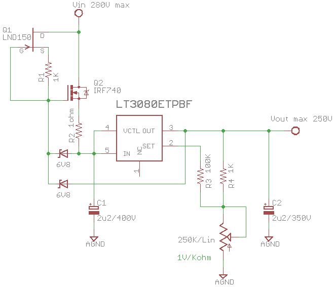

The attached is a high voltage (up to 250Volt/0,4A) power supply.
The Vout is controlled by the potensiometer at 1V/1Kohm.
I'd like to control this voltage by a Microcontroller and replace the potensiometer by an electronic variable resistor of some kind.
Have tried different ideas, like a JFET, MOSFET, BJT but all suffer in one way or another of Temp drift or narrow band of control.
Any idea welcome.

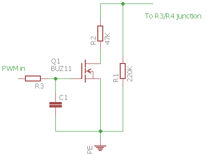

You can drive a high voltage MOSFET in series with a resistor with pulse width modulation to adjust the "average" resistance. That would mean that you would have to filter the feedback signal before letting it into the regulator.
In the case of a single resistor and a MOSFET the average resistance would be R' = R/(duty cycle).
At 0% duty cycle average resistance is infinite (so you might want to shunt the MOSFET with a resistor.
At 100% duty cycle the average resistance is equal to the value of the resistor.

I think you could ditch R4 and regulate voltage directly at the SET pin. Use a pullup to the input pin (with some protection diodes) and a transistor to pull down, controlled by an opamp with some reference voltage source.

AnalogKid: the output range is from 50-200 volts
kubeek: The R3 and R4 are needed both. They form a current divider keeping 10μΑ for the set pin and 1mA the min current for the LT3080 to work properly. Both are then connected to pot regulating output at 1V/1K.
Dick: I used the circuit attached. Unfortuately, resistors does not seem to be simulated well with PWM and duty-cycles. The Enhancement Mosfet is not the BUZ11 but a IRF740 High voltage one. Just did not find it in lib.

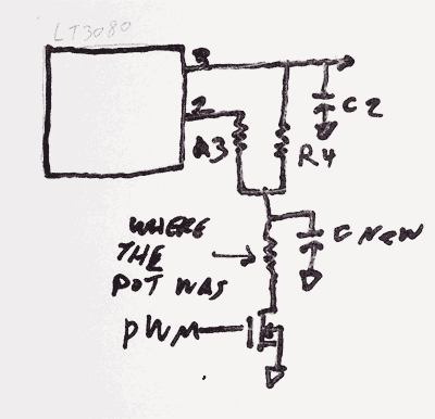

Interesting....The idea is to switch the transistor on and off with PWM, then filter the pulse stream from the divider. The circuit you show should still work but it would pass from full off to full on (practically speaking/writing) over a very narrow range of PWM values. I was thinking of a circuit more like the one below. I should have sketched it out for you in the first place.
Notice that Cnew will affect the regulator's step response -not the best topography for this technique, it would not have an issue with step response if on the reference than on the feedback.
Well, including a capacitor does help indeed.
But,
1. The range of control is from 53 to 58% duty
2. Temp of the Mosfet shifts very much the setting point. No regulation at all!
So, even accepting the small range of control, the temp drift is too much.
Thanks anyway.

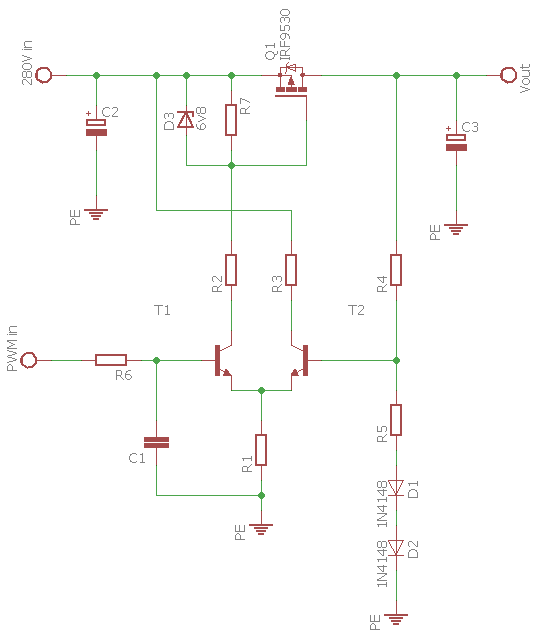

These days I was experimenting with another idea from the Microchip forum Member Paul. He suggested to use a differential transistor circuit driving a PNP or Pchannel Mosfet transistor.
The one transistor of the differential pair is sampling the Vout and the other is driven by the PWM signal. Looks promissing but has a lot of issues to take care, strating with 5-8 volts drop connecting the load to the output.
I attach the temp circuit.
Ioannis
That circuit makes a lot of sense, except that D1 and D2 seem to throw off the temperature stability. Please let us know how well this circuit works once you have ironed out the wrinkles.
