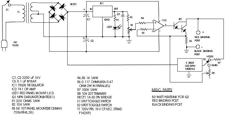

I do not want to distract you, but if you like I will be happy to post a circuit of on I built several years ago that uses a transistor, op amp, fixed resistor and a voltage reference and a DVM to do exactly as you want.
k7elp60:
Please do post it. I believe that not only the original poster but everyone else following this thread would appreciate it.
schmitt trigger here it is. I have been using this for more years than I can remember. I have used it for testing batteries, power supplies etc. The DVM is adj to show current with the pot. I realize that the true current does not include the base current of the darlington transistor that is measured with the DVM connected to the emitter resistors, but when you are talking about amps the base current is not important.
There is one resistor I failed to put in the schematic that is a 1k from the output of the op-amp to ground. The circuit requires a darlington transistor as the variable resistor to work properly.
a circuit ......to do exactly as you want.
:confused: The circuit in post #13 is undoubtedly useful for testing batteries, but it provides a constant current load, not a constant power load as the OP specified.
