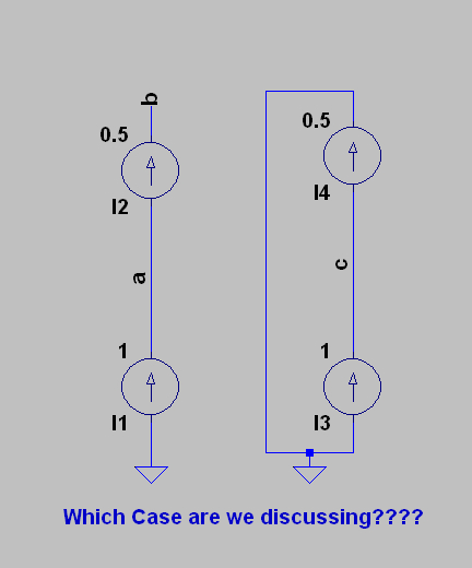

Which case are we discussing?
The rightmost case, where the non-ideal sources are in a circuit. Otherwise there is no current flowing.
As i said two times previously, there is no reasoning for two current sources in series unless we assume some non ideality such as a large resistance in parallel with each source and a small series resistance in series with both. So the circuit i am referring to is:
Two current sources in series, with also a small resistance like 0.001 ohms in series with both.
The two current sources have a large resistance like 10 megohms in parallel with each one.
So that is a total of three resistors, two current sources.
Once we have this circuit established, we can then let the 10 meg's go higher and the 0.001 go lower and see what the effect is.
If both current sources have the same value (say 1 amp to make this simple) then we see some reasonable results. But they must be exactly the same. If they are even a tiny bit different then that affects the outcome.
If this still isnt clear i'll do the whole circuit so we can see what happens. It's mildly interesting mostly because it was already brought up, but in real life i dont think it has any application unless we limit the top end current of the sources, like say to 10 amps or something, so they cant go any higher. Then we might have created a logic gate :)
