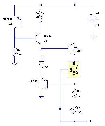

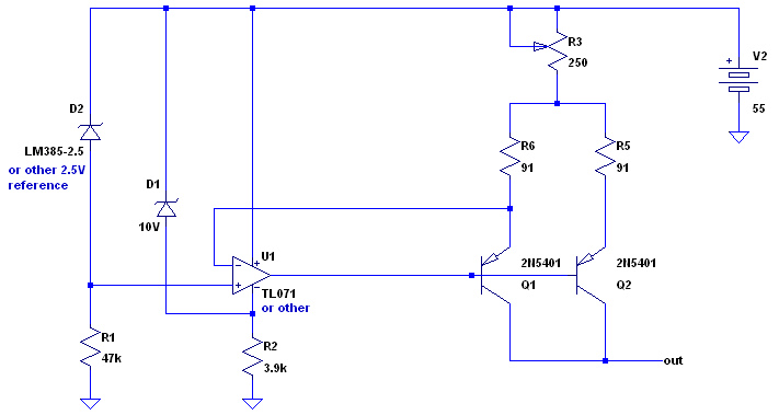

Here are a couple of 10mA - 50mA, 50V compliance current sources that work OK in simulation.
EDIT: The transistors in the first circuit will not handle the power disipation of a load where the current is high but the output voltage is low.

On1aag pointed out the TL783 to me in a PM. It's functionally a high-voltage version of the LM317. It should work in this application, but I have not tested it, and TI does not provide a spice model.

I would like to implement the circuit suggested by roff and eric gibbs, however i must have my lab running tomorrow, so in case i do not have the devices listed to buy from kiesub electronics here at las vegas, i must have an alternative so that the circuit can be built tomorrow positively.
In Roff's circuit
1) in his first circuit, please suggest alternatives to TL071 ,LM 385-2.5.
i THINK 2n5401 is commonly available i guess.
2) In ROFF'S BOOTSTRAP LM317 circuit, please suggest alternatives to TIP 41C.
iN ericgibbs CIRCUIT, please suggest equivalen alternative to TIP 42 in case this is not available.
