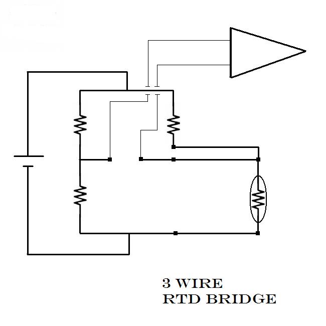

And three wire? Explain why constant current is needed in your design? Can you post your schematic? Constant current is typically used when lead resistance is an issue. 4 wire designs overcome that problem. But your using 3 wire, so please explain the need for constant current?
Your circuit resembles this, right?
Do you see that the bridge itself is your source of regulation?
In fact, a constant current source eliminates the need for a bridge altogether, because the voltage drop across the RTD in series with a single resistor would suffice as long as no current variability occurs.

Hi ke5frf
Thank you for your interest.
I understand that constant current is not needed in my bridge design.
However, do you think I need a constant voltage source OR just a stable voltage output of a +5v SMPS would be fine?
The schematic you posted is mostly similar to my circuit.
I am saying mostly as I have connected the 3-wire RTD up side down and one of the two wires goes to ground and other goes to the other arm's 100e resistor

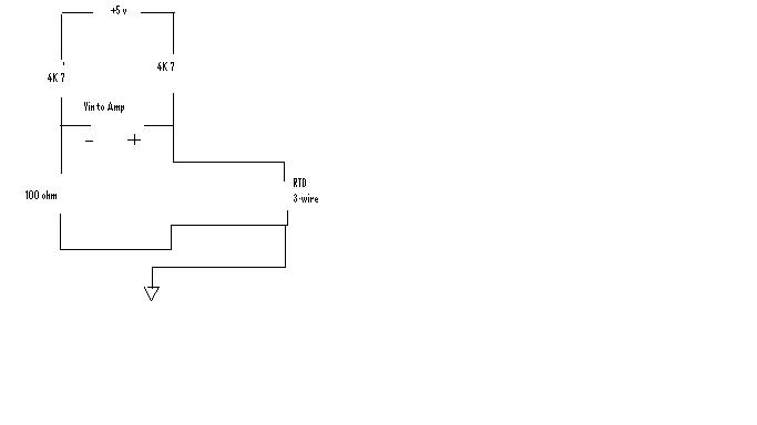

I am trying to use AD623 INAmp after this bridge but as of now not consolidated on that design.
Uploading the schematic for ease of understanding. btw, I am not very good at drawing things on computer!
btw, at present I am planning to power the whole circuit with the same SMPS.
do you think i should go for another regulator just for the bridge in case i need a 0.5 deg C resolution from my application and the range I am targetting is -20 to 200 deg C?

As far as sensor lead noise is considered, is it a fair idea to have disc capacitors put up around both the lower resistances of the bridge?
I am at present using 1% resistors. Not sure if I may get the TCR type you mentioned. I shall check though.
