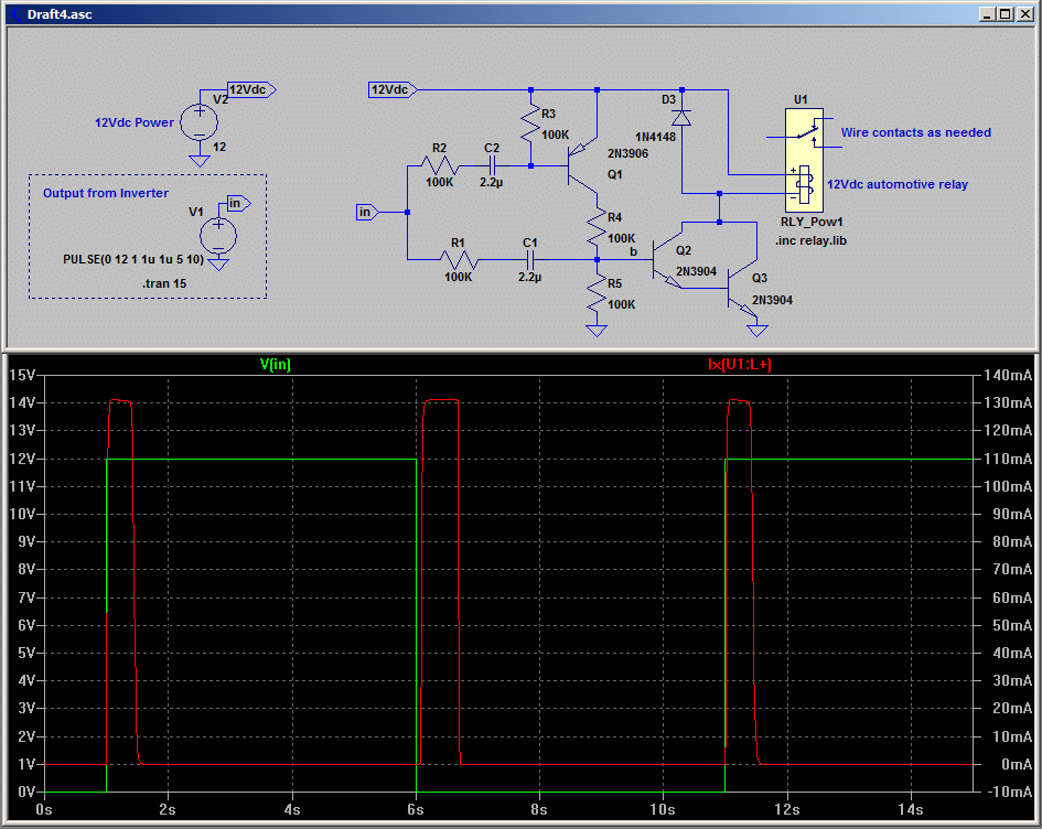

Hello,
My circuit design experience is extremely limited, and I've done a ton of searching but can't seem to find what I am looking for.
Some background: I have a diesel generator that is started by tapping a momentary start/stop button, and stopped by the same action.
I am trying to control it remotely via my off grid inverter, however the inverter just puts out +12v while the generator is supposed to be running and then cuts voltage when it is supposed to stop.
I am trying to come up with a relay or circuit that will take a constant 12v and when it is applied make a momentary contact (to start the generator) and then when the voltage is disconnected it makes another momentary contact thus shutting down the generator.
Any advice or direction is much appreciated.
Thank you

The following circuit, while a bit complicated, does what you ask. It has a relay output, so you can wire its (totally isolated) contacts in parallel with the existing generator's push-button without needing to understand the grounds or voltage levels in the generator.
You will need fused 12Vdc @ 130mA to power the circuit. The good news is that the circuit only draws power for the duration of the timing pulse while the 12V sugar-cube relay (**broken link removed**) is actuated.
The duration of the relay closure is controlled by the time-constants R1C1 and R2C2. As shown, the duration is about 0.5s.
In the simulation, V(in) is what comes from the inverter, and I plot the relay coil current to show when the contacts switch. You can do anything with the relay contacts you like. Likely, you will want only the Normally-Open contacts wired in parallel with the genny's push-button.

Thanks for taking the time to either draw that up or share it, and while I have to say in all honesty I don't understand how it works, I am perfectly capable or ordering the components and sticking them together. I'll wait for the generator to show up to test and get exact contact timing for start up and shut down in case there needs to be a modification. Your power requirement sounds very specific, I will look into a supply that is 12v 130ma exactly.
Again thanks for taking the time, I will take some time and try and understand the circuit.

Hey Mike,
I've decided your circuit is probably the simplest and most cost effective method. Can you help me with a couple of rookie questions, what software did you design the simulation in?
I'd like to get a copy, I'd also like to get the contact time down to about 1/4 of a second on both the inital and the final connection.
Lastly when I am sourcing the components what voltage am I looking for as I see dozens of different resistors that are 100k and caps that are 2.2u etc.
Sorry for the elementary questions. And thanks for your help
..., what software did you design the simulation in? I'd like to get a copy,...I'd also like to get the contact time down to about 1/4 of a second on both the inital and the final connection.
LTSpice. Free download at www.Linear.com. I will post the .asc (sim) file which you can use as a tutorial, except that you will not have the relay library, so when simulating, just use a ~85Ω resistance (~resistance of the coil of the automotive sugar cube relay) in place of the relay coil.
Lastly when I am sourcing the components what voltage am I looking for as I see dozens of different resistors that are 100k and caps that are 2.2u etc...
I would use **broken link removed**
**broken link removed**, + on the right end.
C1,**broken link removed**, + on the left end.
