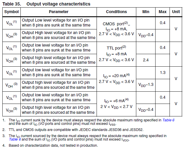

I downloaded the datasheet for the STM32F101x4, I did not know your exact part, should be similar. In the datasheet is a table for the I/O. I think your SLA is most likely TTL compatible, according to the ST32 datasheet, (see attached table) it outputs TTL/CMOS compliant voltage levels which means you should not need any extra interface. If you can breadboard it for a test, I would try it. Bottom line, I think your good to go.
Output voltage levels
Unless otherwise specified, the parameters given in Table 35 are derived from tests
performed under the ambient temperature and VDD supply voltage conditions summarized
in Table 8. All I/Os are CMOS and TTL compliant.

I am using a STM32F091 nucleo which according to this document
https://www.mouser.com/ds/2/389/DM00115237-524529.pdf
uses a VOL of 0.4V and a VOH of VDDIOx-0.4 (or 1.3?? confused) (page 82)
but I am planning to use either SLA7026 with VIN H 2.0 and VIN L 0.8
or as recommended by the manufacturer SLA7083 with VIH VDD*0.75= 3.75 and VIL= VV* 0.25= 1.25
Which means that if I use SLA7026 I am good to go 2.9>2 and 0.4 <0.8 but with SLA7083 I cant! (2.9<3.75!)

I agree. The ST32 data sheet states the outputs are TTL and CMOS compliant. If in doubt, I would call a ST Field Apps engineer, or use their support forum. This simple phone call can save time, effort, and unnecessary components added to the design. But that is just my opinion, and ultimately it is the designers decision.

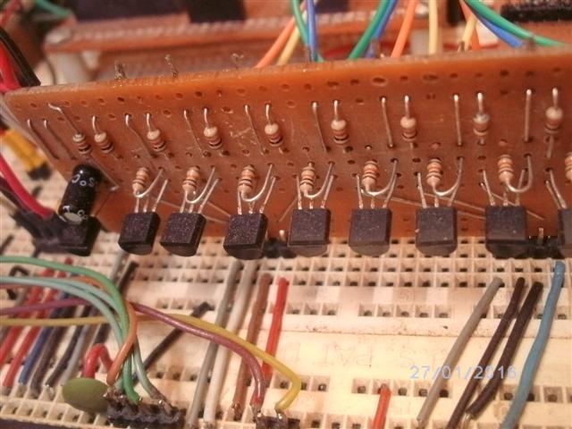

Long weekend ahead, I needed to connect a (5V Vdd micro) to an RN42 BT module.
It took few hours for a protoboard test and to have one for 8 bits up and running in the first try.
The resulting hardware was a kludge but worked.
