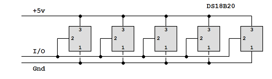

Would anyone consider an 8-pin microcontroller and Maxim/Dallas "one-wire" DS18B20 temperature sensors (-55°C to +125°C)?
Use 1 pin on the microcontroller to drive N number of sensors daisy chained on a 3 wire bus (+5v, Ground, and the "one wire" data I/O line). Use another two pins for serial I/O to the 'host'.
Simply connect the sensors to three wires at the correct intervals, add some insulation between, then pull it through the PVC pipe or other conduit before capping the ends and installing in the silo.
You could also use the extra microcontroller pins to drive a relay controller IC and easily add programmable "set points" to control fans or other devices. Program the "set points" from your 'host' device, disconnect the 'host', and let the microcontroller do all the work for you.

Your approach is so simplistic...I love it...but I was wondering one thing though...if you had multiple sensors....and they are on the same bus, how does the processor know which one it is reading from?? After reading the DS18B20 datasheet, I realize that each has a unique address, but is there any way of knowing what the address is before it is in the circuit??
Say in this example you have a temp sensor at ground level and then every 3 ft going up. How can you just read the 12ft sensor and how can you know for sure that you are reading that sensor versus the 9ft sensor??
Once again....I just love the simplicity of your diagram...it is great!! thx...
Presumably you need to set each address before you connect them in circuit?.

Off the top of my head, I would suggest a "test" or "id" jack on the controller as well as the normal "bus" jack. Then perhaps plug in each individual temperature sensor one at a time into the "test"/"id" jack to identify and label that particular sensor. For example, if you labeled it as "#3" or as "12 foot" then it would be up to you to make sure you place it at the 12 foot mark when you plug it into the 3-wire cable run in the silo.
The PIC controller would address and query each temperature sensor one at a time.
